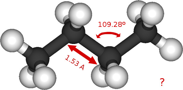

I attached a picture of what I think this means. (I could be wrong.)
If you want to include hydrogen atoms, you will still need the CH
distance(s), CCH, HCH angles and HCCH and HCCC dihedrals (and CHHH and
CCHH impropers).
I hope this gets you started.
Andrew
