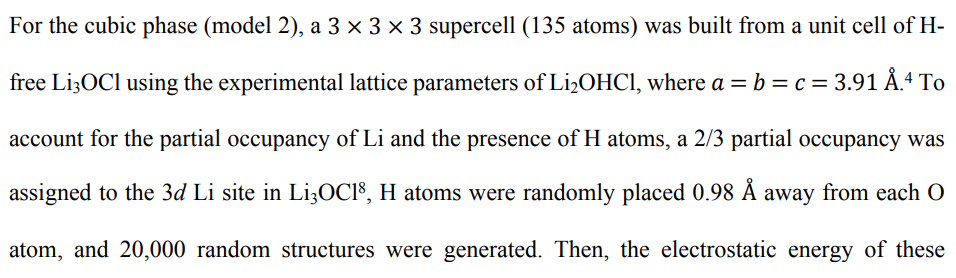

I am trying to add H atoms to a system randomly, limiting with the constant distance between O and H, the detailed steps are shown in the figure.
But i do not know whether the pymatgen can realize this process, Can someone help me with this?

Not sure if you already solved this by now but to give you a rough layout of how to do this with pymatgen:
Loop through sites in your pymatgen structure:
- if the site is an oxygen store its cartesian coordinates
- Initialize a random vector (e.g. with numpy) divide it by its length and multiply it by 0.98.
- Add site of H with the following cartesian coordinates: The oxygen cartesian coordinates from step 1 plus the random vector from step 2.
