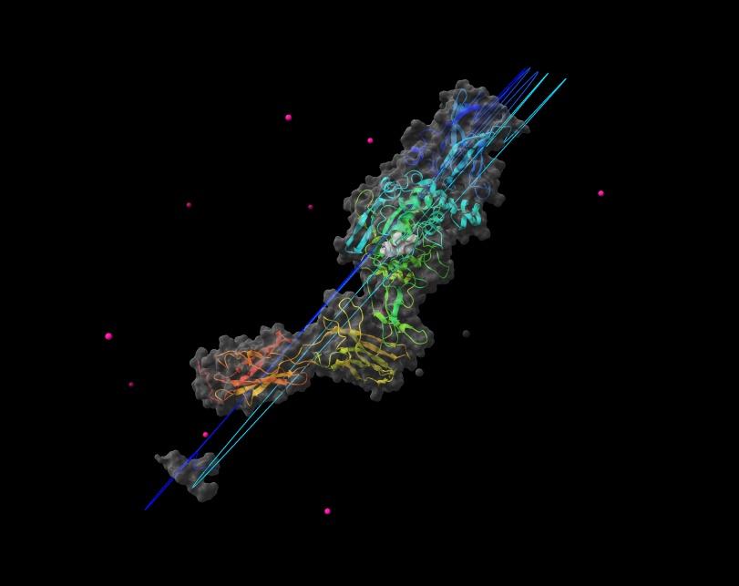

open 4pyg-3mM.psf coords 4pyg-3mM.dcd
rainbow residues target c
surface #1 transparency 62 color gray replace true
surface enclose :277,335,358 color white replace false
show :ASP,GLU atoms
color @cal deep pink
