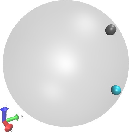

However this is not what happened. When I run the simulation both
particles (2 and 3) stick to the wall.
(See attached figure.
