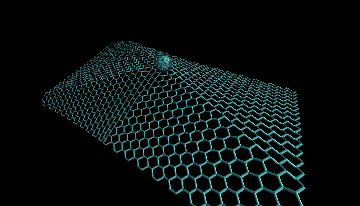

Hello dear all
I am studying of c60 motion on a single_element 2d substrate. the substrate will wrinkled after the simulation done completely!. I 'd like to prevent the wrinkling of substrate therefore I consider some fixes on the simulation, like “fix setforce” but it makes no reciprocal force on other atoms so the simulation is going wrongly and unnaturally.
I applied “aveforce fix” and also “spring fixe” with periodic and fixed B.Cs. Finally the fixes can not prevent the wrinkling of substrate.
can I use lammps by default commands to prevent the wrinkling? or should I change or set the intellect behind of commands in source code manually?
thanks in advance

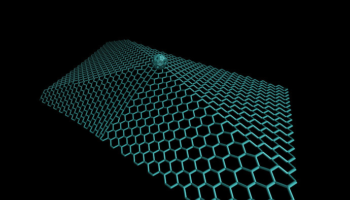

the purpose of the simulation is to study the motion of c60(translational and rotational) on a 2d substrate made by single-element hexagon structure. something like the study of c60 motion on a graphene.
all potentials applied and defined well. “B.Cs” were considered p p f and “nvt fix” used for substrate atoms, But, the substrate as shown in the figures uploaded below wrinkled which is unwanted for the simulation.
how should I remove the fractures or wrinkles on the substrate?

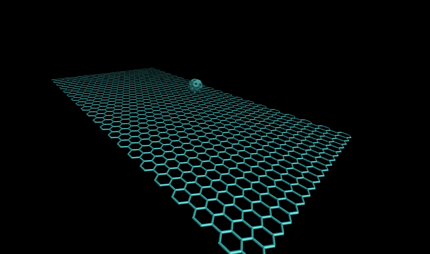

It has solved.
the simulation box(SB) dimensions was the cause of wrinkling. First ,I considered values for SB in two dimensions(except z-coordination) much larger than the substrate. As new dimensions assigned into the simulation box(SB), the wrinkling of substrate would not be seen consequently. the new SB dimensions are bigger than the substrate(in two dimensions(x,y)) as much as the bond length of atoms.
