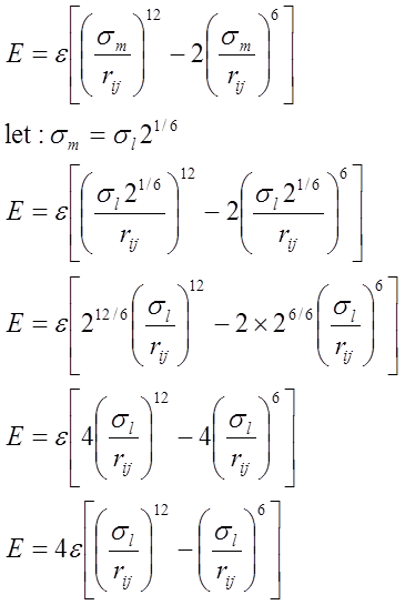

Fatemesadat,
You can convert from one form to the other. See attached picture.

Fatemesadat,

this has to be a typo and Rmin != sigma
the CHARMM force field parameter files have in them:
V(Lennard-Jones) = Eps,i,j[(Rmin,i,j/ri,j)**12 - 2(Rmin,i,j/ri,j)**6]
jan-michael has already shown you how to interconvert these
based on the fact that Rmin = 2^(1/6) * sigma for a 12-6 LJ potential.
