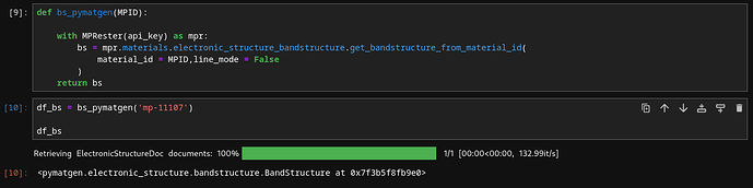

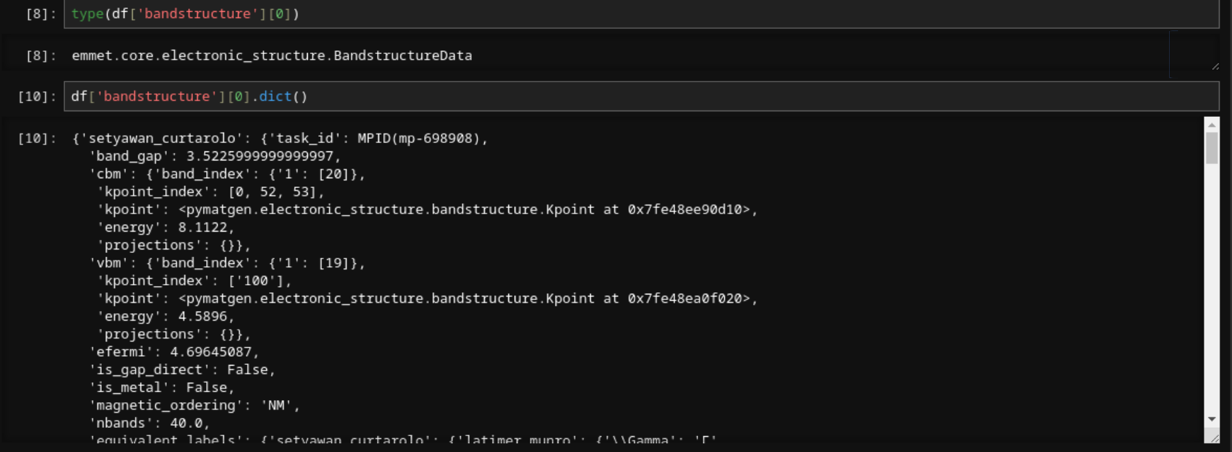

I’ve been trying to retrieve crystal structure data from the MP database for featurization using Matminer. I used the summary.search() method of the new mp_api but I couldn’t find an efficient way to get the bandstructure data in <pymatgen.electronic_structure.bandstructure.BandStructure> format. Matminer featurizers take pymatgen bandstructure data as the function argument. As of now, most end points of the mp_api that I’ve tried return the bandstructure in <emmet.core.electronic_structure.BandstructureData> format.
Although there are end points like materials.electronic_structure_bandstructure() that return the data in the required format (<pymatgen.electronic_structure.bandstructure.BandStructure> format) using this method to retrieve the bandstructure alone is time consuming.
Please let me know if there’s any way to convert the <emmet.core.electronic_structure.BandstructureData> data into corresponding <pymatgen.electronic_structure.bandstructure.BandStructure> data. Or if there’s any way for me to retrieve pymatgen bandstructure data in bulk using the search() or similar methods.

Below is the emmet data object that search method from mp_api returns.
The required data type from the band structure endpoint of the mp_api
