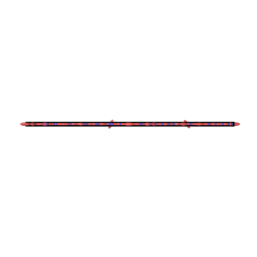

When I use “rigid/npt” to compress the box containing rigid particles (an ellisoid + two spheres) in 2D with “fix enforce2d”, some particles rotate to z-axis direction like the figures show. The interaction I use is gayberen potential.

I add the keyword “torque” in the “fix rigid”. It works.
But if I use “fix rigid/npt/small”, I cannot use the keyword “torque”. So I change to “fix rigid/npt”.
I hope it can be helpful.
