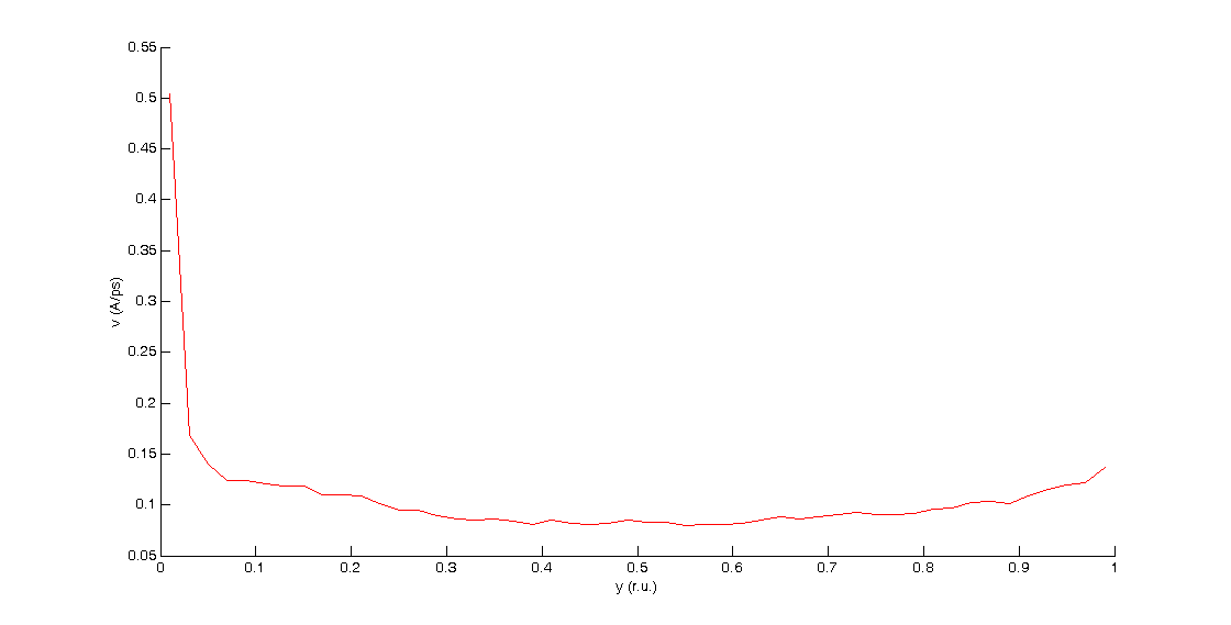

I have resigned from OCSA and applied for a position at the Office of Maintenance of Simple Affairs (OMSA). To impose a uniform flow, I followed your method of initializing the velocities from a Gaussian distribution and adding the flow velocity on top of that. I did this on atoms in one end of the simulation domain one lattice unit thick every 0.5ps. The flow velocity is 0.1-1.0A/ps. I thermostated (using fix NVT and compute temp/partial) the flow in the direction perpendicular to the flow. I have also tried using fix NVE. However, the velocity profile is not as expected. There is a drastic drop in velocity outside the region where the velocities of the atoms are reset as shown in the attachment. The region has a thickness of 0.02 in reduced unit and y is the flow direction. I would appreciate it if anyone from OMSA could provide advice.
Marcus
Try it with no thermostat. Do the atoms maintain their
flow velocity? If not, what is slowing them down?
Steve
