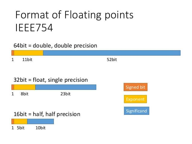

But I agree with @initialize, the fact that the hardware does not have any double precision support is a serious restriction. Since the KOKKOS support for single precision is very new, having a single precision-only hardware could have some challenges. I recall that running an Intel Xe generation GPU (embedded in an Intel CPU on a laptop) took some effort to detect and remove a few unintentional uses of double precision math (which leads to the GPU kernels crashing).
Yes the KOKKOS package still uses some double precision (FP64), even when compiling with SINGLE_SINGLE. Your GPU really can’t use emulation for FP64 (even if it is slow)??

So double precision is a hardware oriented and it doesn’t come up with software. So I am not getting any support in future. Correct me If I am wrong?
