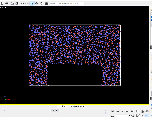

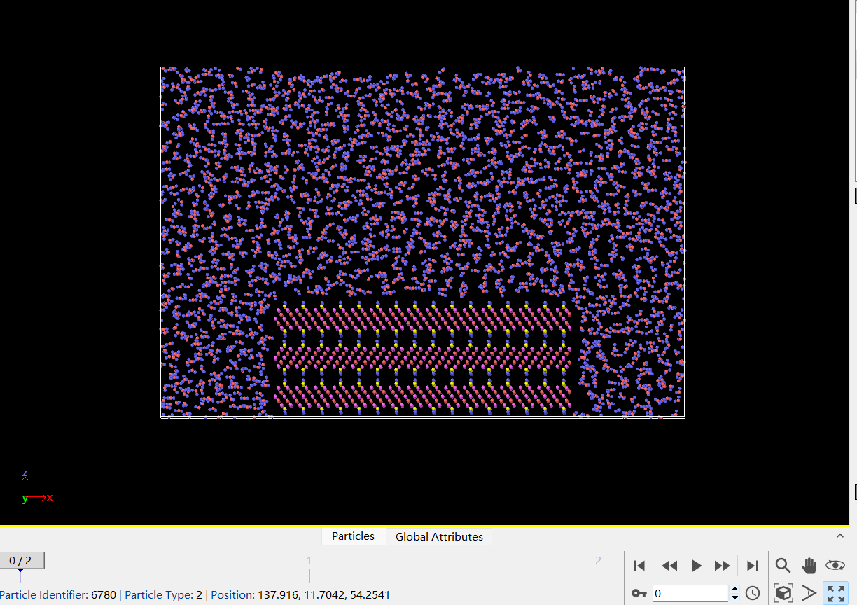

To add some details, the two-dimensional material suddenly disappeared
That shows where the forces diverted.
