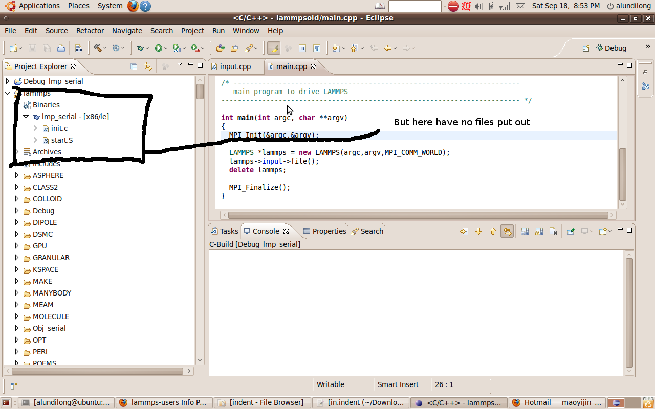

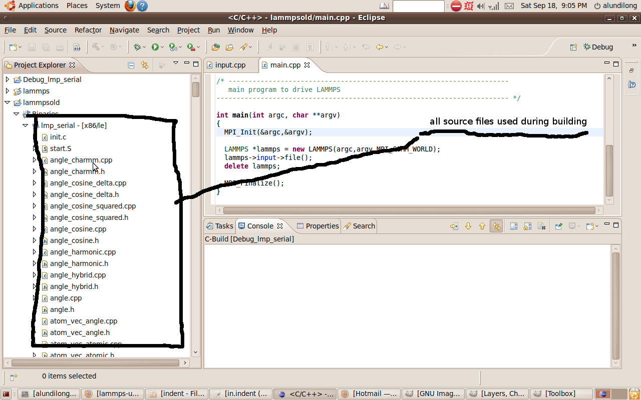

why Lammps (recent version) can not be debuged under eclipse? I am not sure whether it is a bug. I attached two pictures.

there is no problem debugging lammps. you have to make sure that
the -g flag is included when compiling and linking and that the source
directoryis known to the debugger.
