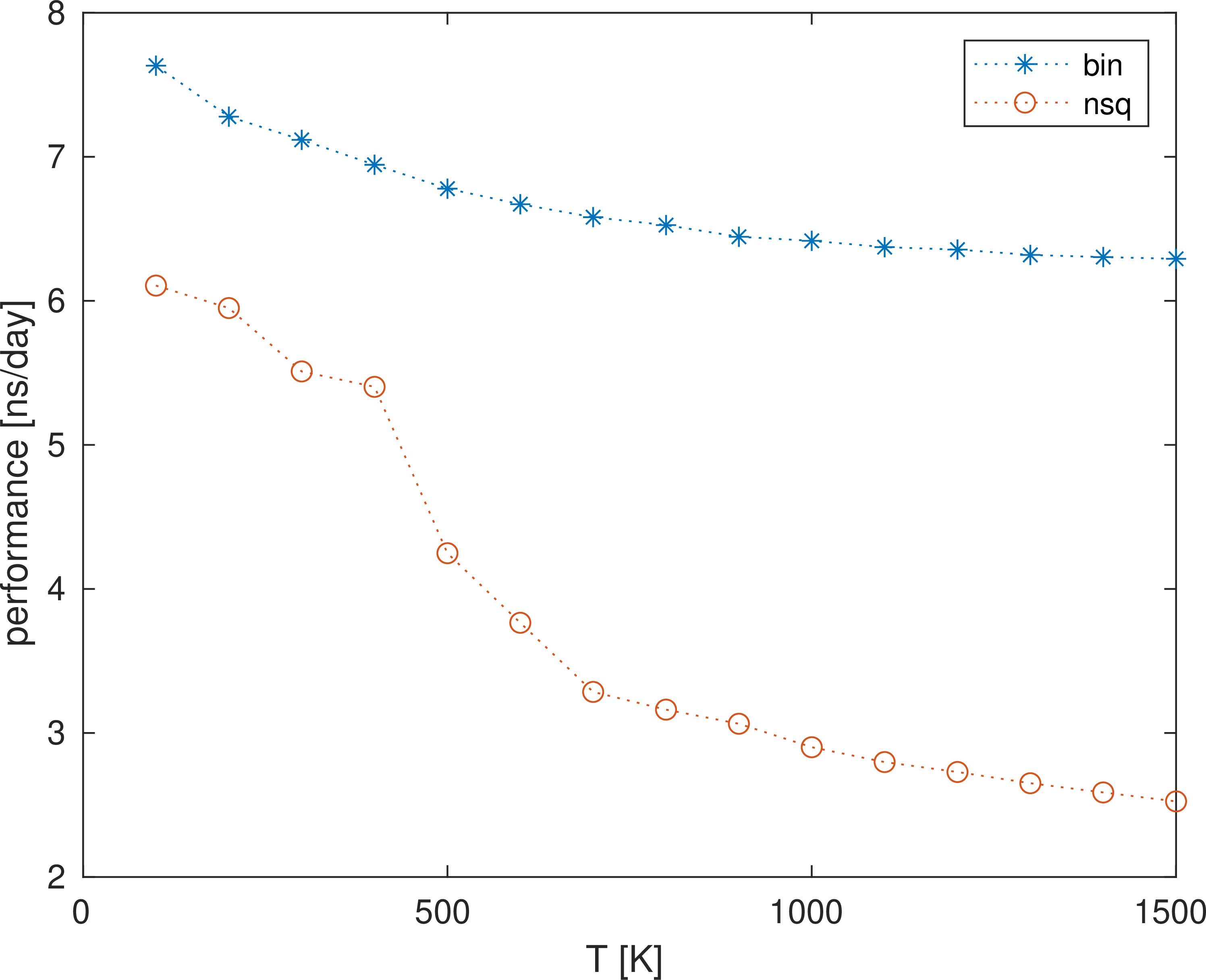

I’m doing short NpT simulations with fixed timestep. Surprisingly, the calculation performance of the simulation seems to depend on temperature. Well, it should not, as I have the same number of atoms and the same timestep.
I turned out it is due to the line neighbor 1.0 nsq. When using instead the default bin, the performance also decreases, but only very slightly, as the atoms are more randomly disturbed from the equilibrium positions.
Is this expected for nsq? I’m not using nsq on purpose. I got it from the example/elastic, where it is used. Maybe it should not be used there? I know, it does not use dynamics, but I suspect the same performance problems also during minimize on non-equilibrium samples.
This is for Tungsten, 1500K may seem a lot, but Tungsten is still BCC at these temperatures. Used potential can be found on NIST. I can reproduce the same with different potential as well, just the extent of the performance drop is different.

You are right, the density in my case decreases slowly and smoothly with the increasing temperature due to the thermal expansion. There is no phase change though (no melting). I agree with you and this explains the behavior of bin. But with nsq there is a sudden drop of more than 2x which is surprising and puzzling to me.

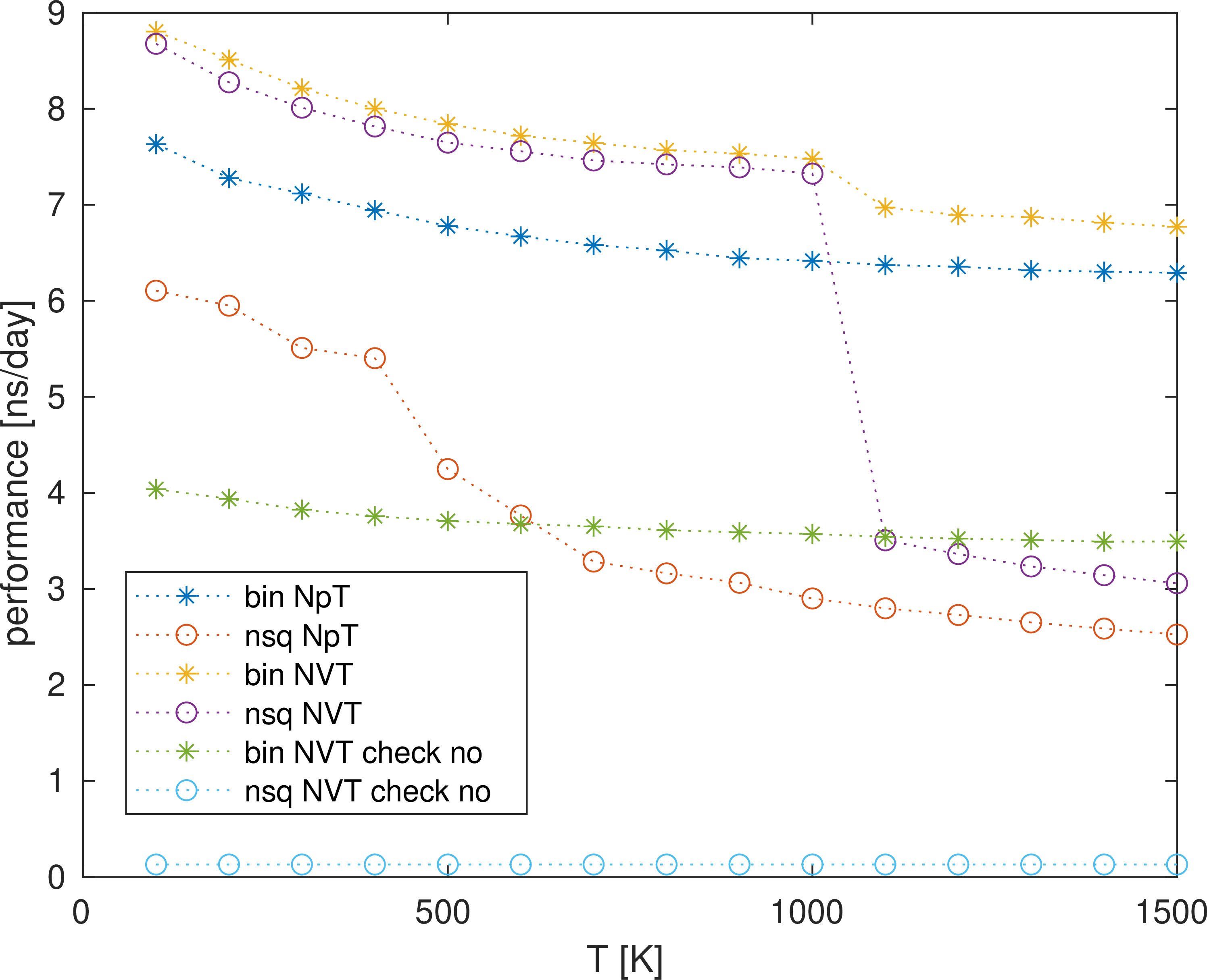

I think I finally understand, what is happening. Thank you both. Actually in NVT the slowdown in nsq is even more pronounced than in NpT. So it is not the change of density in this case. Switching neigh_modify check no triggers the search for neighbors in every step and the performance stops to be temperature dependent. But it is slow, especially with nsq.
As I understand it now:
  • for large sample nsq is very slow compared to bin
  • for the example/elastic nsq is there, because the sample is small and there it is faster than bin
  • larger temperature triggers neighbors search more often
