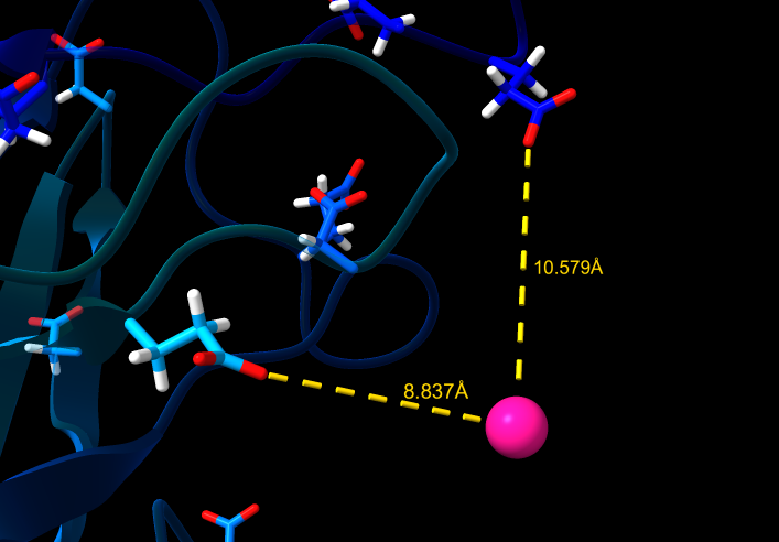

I’m trying to measure and log the distance(s) anytime a calcium cation (2+) comes within the lj/charmmfsw/coul/long pair cutoff of two carboxylates (1- each) on side chains of aspartic and glutamic amino acids. Here’s an example of such an interaction:
