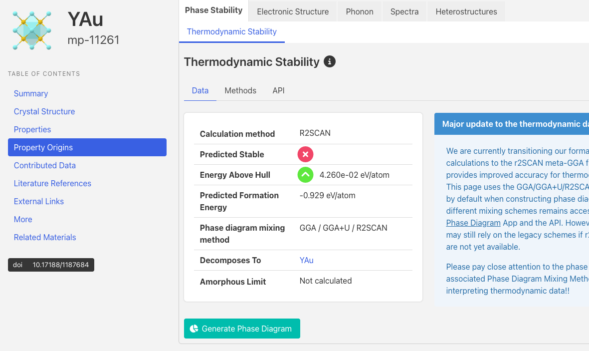

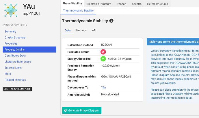

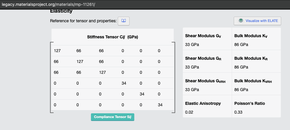

Example 1: YAu
For example, mp-11261 YAu has failed state via API with shear modulus -8.5, yet on legacy website it shows 33GPa.
On next-gen it shows nothing.

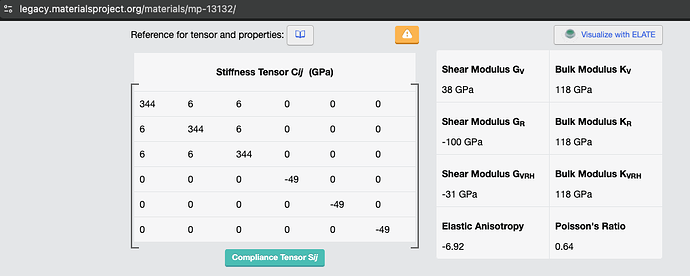

Example 2: mp-13132, LaN
mp-13132 has the same problem: deprecated, failed, negative shear modulus (-41GPa) via mp api, but websites show different
legacy shows a different (??!) negative shear modulus
next-gen shows nothing?

  2. Differences between the legacy website & next-gen: All data shown on the legacy website was essentially frozen at the time of the next-gen switch. Some static data products might have been migrated, but in general the data on the legacy website and the next-gen website (+ mp-api responses) should be considered disparate data sets, so the legacy elasticity data has no relation to the data shown on the current website. The workflows that produced the data are even different (very different if I remember correctly).
  3. next-gen showing nothing for those two materials: The website does not show deprecated entries in any of the interfaces/apps but they are available via mp-api.
