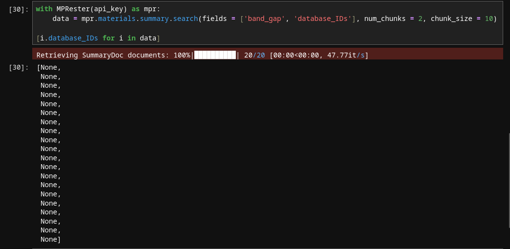

Hi everyone, I noticed this a few days ago; MPRester queries requesting database IDs are not returning them as they used to. The code snippet below shows the response to one such request. For the project I’m working on, I need the source database IDs of materials. Any help is appreciated.

Thanks for reporting this, we’ve identified the issue and are working on a fix. Should be solved within a couple hours.
Will update when this is resolved.
This has now been fixed, please upgrade mp_api and emmet-core to their latest stable versions ( mp-api==0.45.11 and emmet-core==0.84.10)
