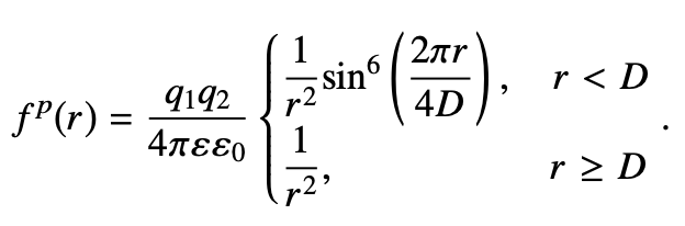

Dear LAMMPS developer,
Recently I tried to develop a modified style of Coulombic force by editing both the pair_coul_cut.cpp and pair_coul.cut.h, and after this I successfully compiled and built the lmp executable with no error thrown out. For this new pair style I name it coul/test.
Then I tried to output the values trying to validate that my new style is working, I used the scripts below. However, I found that the set of values generated in this table.txt somehow is still as the shape of the original Coulombic potential.
So I doubt the pair_write command has used the new formula encoded in the .cpp file. I don’t know whether it’s I wrote the .cpp file wrong or I used the pair_write command in the wrong way.
Here’s the .in file:
lammps_pair_coul_test.cpp (9.12 KB)
GM.dat (154 Bytes)
The pair_write command uses calls to the Pair::single() function to
generate the table (with the charges being set to 1 and 1 if not given
explicitly in the command).
When thus to validate your implementation you need to update
Pair::single() as well and then I would suggest that you compare the
result of pair_write
to a system with 2 atoms where one of them is moved at constant
velocity with fix move and then you record energy and force via
thermodynamic output of fix print.
