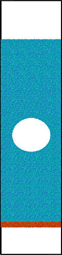

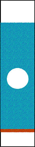

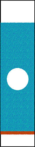

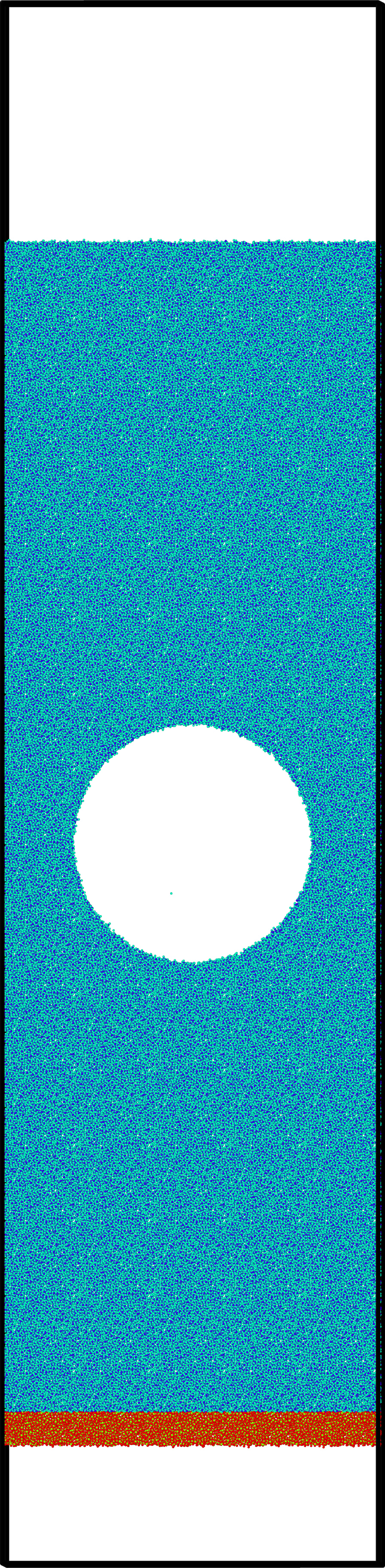

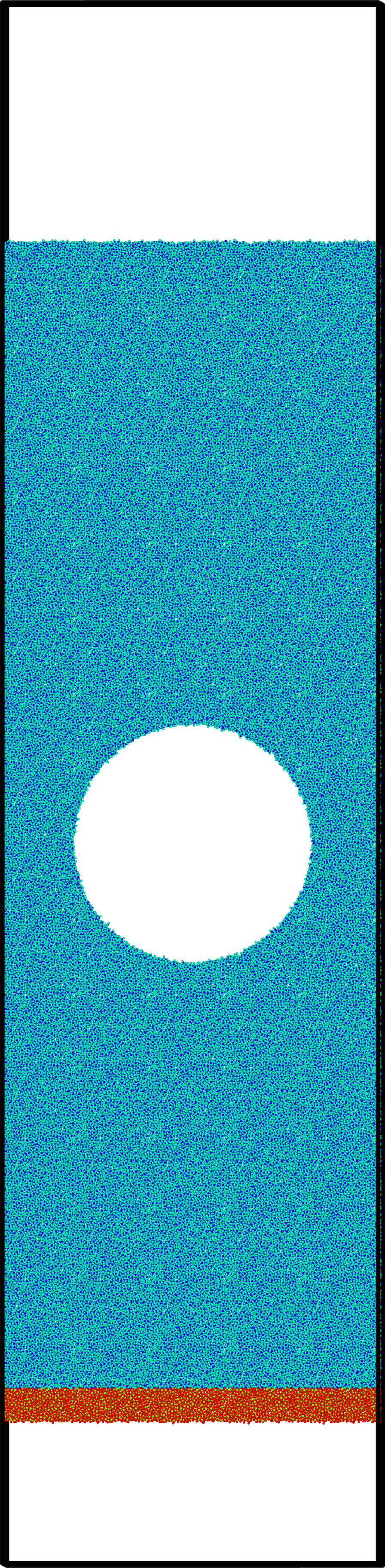

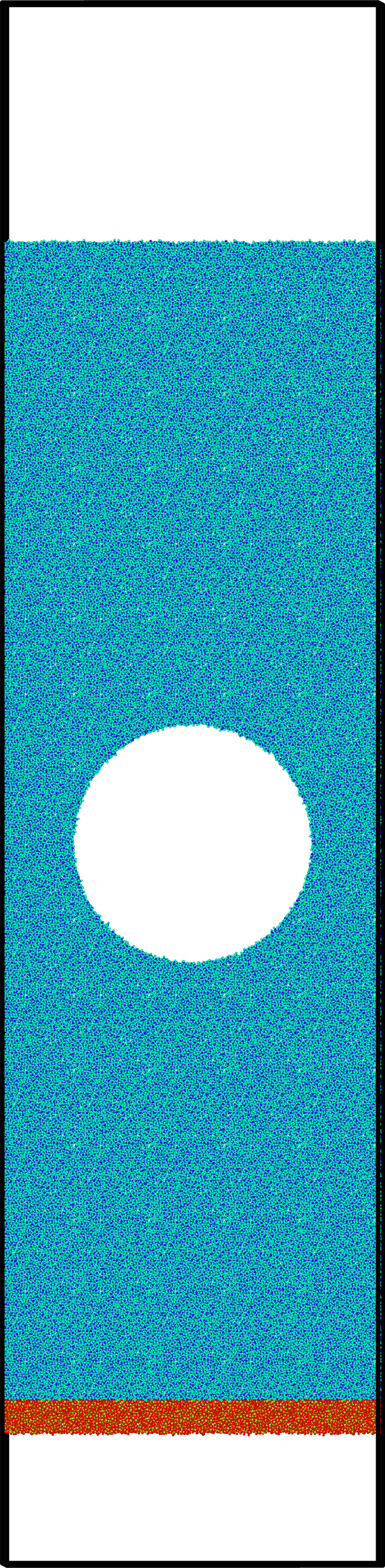

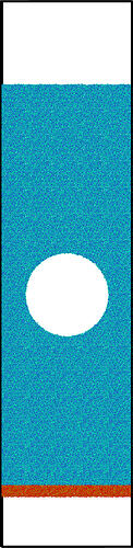

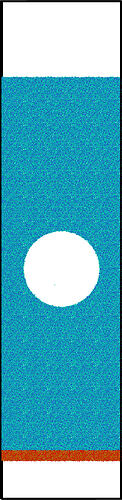

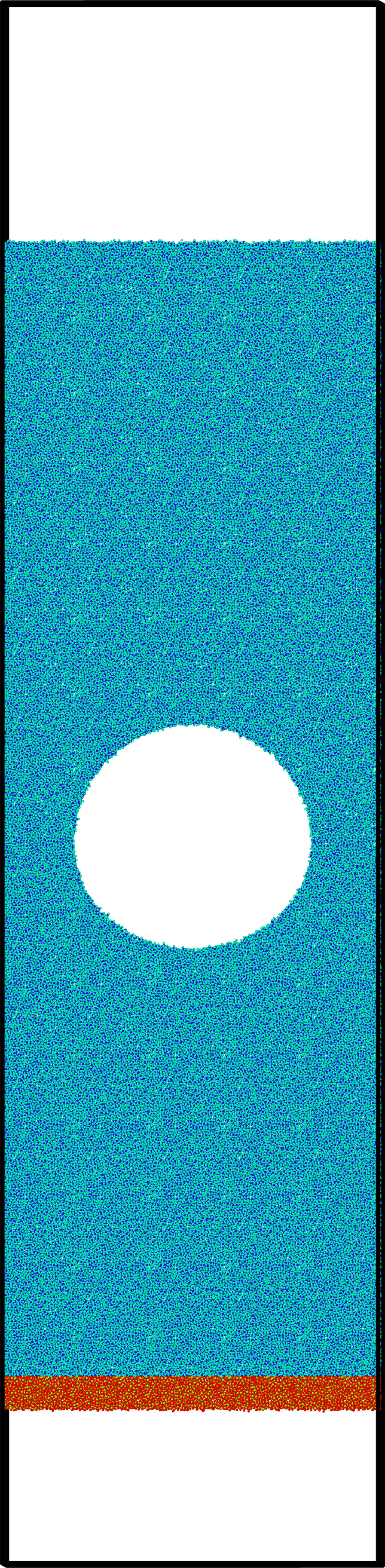

Here are the central YZ cut (2 nm thickness) snapshots of the simulation at 0, 2, 4, 6 and 8 ps (piston atoms are just colored differently to detect its movement):

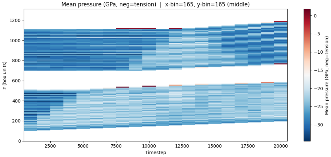

So the average pressure in the system is rising (as I assume due to the compression coming from the piston movement).
However, when I analyze “Pressure_total.out” file, all the chunks have negative ‘meanpress’.

So the pressure is negative everywhere, while in a compression simulation like this it should normally be positive, just like in log.lammps.
I also tried to output virial pressure only (“Pressure_virial.out“), but the values are similar to total pressure values:

I also live here the total pressure colormap along Z chunks for central X and Y chunks:
Of course, I understand that I have reflection from the rear boundary, but that’s at later times, in the beginning I expect the pressure to be positive like in log.lammps.
So I have three questions:
  1. Why the pressure is negative
  2. What is the correct way to treat the rear surface to model shock wave propagation in bulk silica without reflection? should I dump the velocity of atoms, using fixes like “fix setforce“ or “fix viscous“, or put a second piston at rear surface and fix it’s position or allow it to move dynamically?
  3. What is the overall best way to model shock wave propagation in porous silica? Is piston the best approach, or something like “fix msst“ or maybe other thing I don’t know exists?
Thanks a lot in advance.

Thanks for posting the actual input — that makes this answerable. There are
really two layers here: (A) why your per-chunk pressure comes out negative, which
is a postprocessing issue, and (B) a couple of bigger-picture concerns about
whether the model and cell are set up to answer the question you have in mind.
I’ll take them in that order, then address your rear-boundary / method questions.
A. Why the local pressure is negative
1. The per-chunk estimator is the likely culprit (average-of-ratios)
You build a per-atom pressure first and then let ave/chunk number-average it:
variable p_tot atom -(c_spa_tot[1]+c_spa_tot[2]+c_spa_tot[3])/(3*c_volvoronoi[1]*10000)
fix press_tot all ave/chunk ... chunkYZ v_p_tot c_volvoronoi[1]
That computes the mean of Sᵢ/Vᵢ over the atoms in a bin, which is not the
local pressure. The local virial pressure of a chunk is the ratio of sums, not
the mean of ratios:
P_chunk = -( Σ Sxx_i + Σ Syy_i + Σ Szz_i ) / ( 3 · Σ V_i )
The two agree only if every atom has the same Voronoi volume. They don’t — and
pre-dividing by V_i per atom strongly over-weights atoms with small Voronoi
cells
. A handful of those with an opposite-sign virial can dominate the bin
average and flip both its magnitude and its sign. This is the most likely reason
you see a uniformly negative result whose magnitude doesn’t track the bulk
pressure.
The fix needs no new computes — just average the extensive stress components
and the volume separately and combine them afterwards:
fix press_tot all ave/chunk ${Nevery} ${Nrepeat} ${Nfreq} chunkYZ &
    c_spa_tot[1] c_spa_tot[2] c_spa_tot[3] c_volvoronoi[1]
then form -(Sxx+Syy+Szz)/(3*Vsum) in postprocessing. (Because the atom count
cancels in the ratio, using the chunk averages of S and V is equivalent and
avoids the per-atom division entirely.)
2. A decisive cross-check
Before going further, sum the per-atom stress over all atoms and divide by the
total box volume, and compare to thermo Press / Pzz. You already have both
stress/atom NULL (spa_tot, virial+KE) and stress/atom NULL virial
(spa_vir, virial only), so this is essentially free:
  • If the global per-atom sum matches thermo but the chunks don’t → it’s the
    binning/volume estimator in point 1.
  • If even the global doesn’t match thermo → the problem is in the volume
    normalization or the tally, not the binning.
  • Comparing p_tot vs p_vir chunk-by-chunk isolates the kinetic contribution.
3. Remove the streaming velocity from the kinetic term
stress/atom NULL uses lab-frame velocities, so behind the piston the bulk
drift
enters the kinetic part of the stress. For a shocked/streaming system the
kinetic stress must be built from the peculiar (thermal) velocities. Pass a
binned, bias-removing temperature compute as the first argument instead of NULL:
compute ctmp all temp/profile 1 0 0 1 z ${nbins}   # or compute temp/chunk ... com yes
compute spa_tot all stress/atom ctmp
This term is positive, so it isn’t what makes your result negative — but as
written the “thermal” part of p_tot is contaminated by the piston motion and
won’t be physically meaningful.
4. Voronoi volumes are ill-defined next to vacuum
With a 10 nm pore and a non-periodic p p f boundary, atoms at the pore wall and
the free z-surfaces have unbounded / clipped Voronoi cells. Those are exactly the
small-or-huge-volume outliers that wreck an average-of-ratios. Restrict the
analysis to a bulk group (exclude a surface/pore skin), or at least flag those
bins.
5. thermo Press is not comparable to a local chunk value
Press in the log is a whole-box average — early in the run that is mostly
unshocked material, plus the box-wide kinetic term and the total volume in the
denominator. A magnitude mismatch versus a local shocked bin is expected; only the
sign flip is a genuine bug.
