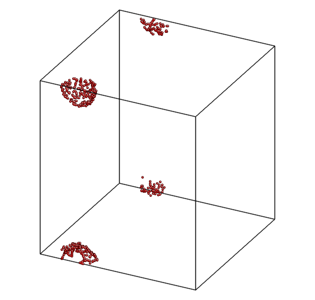

I have some problems with the results of compute com/molecule and compute gyration/molecule.
I have a cluster of atoms (they have the same molecule tag) and as you can see in the attached snapshot, they are partitioned into 4 pieces by the periodic boundaries. When I used compute com/molecule and compute gyration/molecule to calculate the group’s center-of-mass (COM) and radius of gyration (Rg), the results seemed unreasonable. COM was in the middle of 4 separated pieces rather than inside the molecule. As a result, Rg was much larger than it should be.
I have a cluster of atoms (they have the same molecule tag) and as you can see in the attached snapshot, they are partitioned into 4 pieces by the periodic boundaries. When I used compute com/molecule and compute gyration/molecule to calculate the group's center-of-mass (COM) and radius of gyration (Rg), the results seemed unreasonable. COM was in the middle of 4 separated pieces rather than inside the molecule. As a result, Rg was much larger than it should be.

both computes are dependent on your initial configuration having
correct image flags set.
have you checked the original data file? can you write out a restart
and convert it with restart2data and check it?
