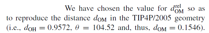

As you might know, One of the reason of developing these flexible TIP4P potentials was to be able to mimic vaibrational mode. In these models, the position of negative charge (qdist) is variant w.r.t. the position of other atoms. However, I saw on the internet that some people use qdist = 0.1546 which I doubt about using it as a constant based on the content of the paper [1]. This constant qdist should be correct only when the atoms in a molecule lie in their ideal position. Thus, it changes during a dynamic simulation. I attached the formula and the Author’s explanation from the paper here.
Please note that people reference to [1] as TIP4P/f and to Habershon et al. work as q- TIP4P/f in the literature.
