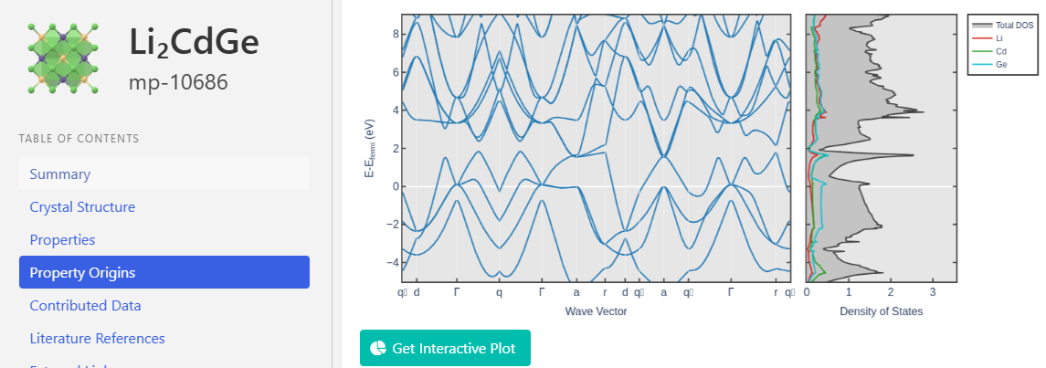

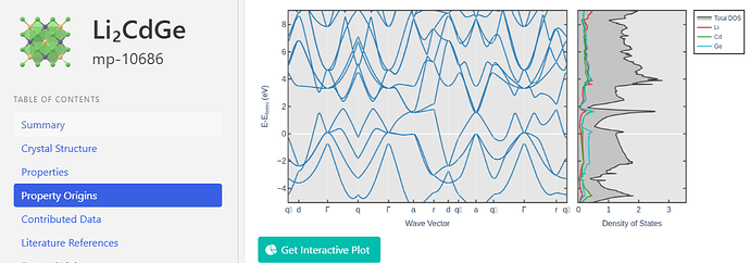

There is a DOS difference between showing in MP website and obtaining by python code

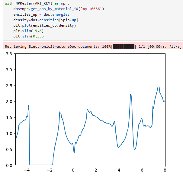

Hi, i try to download the dos data through MPRester. While the dos plot is very different to the MP website,
. , I am wandering if i made something wrong for the code?

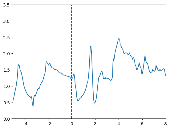

Hi chaohong,
Most of the code looks correct. The only issue is that the energies should be referenced to the Fermi level by subtracting dos.efermi.
energies = dos.energies - dos.efermi
density = dos.densities[Spin.up]
plt.plot(energies, density)
plt.axvline(0, color='black', linestyle='--' )
plt.xlim(-5, 8)
plt.ylim(0, 3.5)
