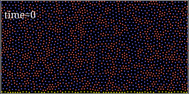

I am using LAMMPS to study a bonded network which is semi-periodic. My x-directions are periodic, and y-directions are fixed, and no atoms form any bond across the y-boundaries. However, I have bonds that do cross the x-boundaries. And I am using a simple harmonic bond style. I simulate in the microcanonical ensemble, i.e. NVE, from this simple unstressed/unperturbed network where the distance between two atoms is equal to their equilibrium length, so no force is acting between any two atoms, and no potential energy is expected.

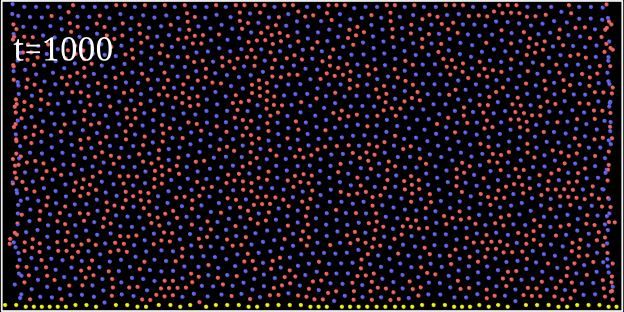

However, I am observing a shrinkage in the x-direction due to all the bonds that crossed the boundaries.

The input file, data file and log files are attached. Also, the images of before and after are attached.

Looking at your data file, it looks like this may not be exactly the case for your harmonic implementation. E.g. bond #2150 has an equilibrium length of 140 which does not reflect the distance to the nearest periodic image (~2).
Given periodic issues in your data file for harmonic, I’m surprised harmonic/restrain gives similar errors. I assumed it correct PBCs, but I can’t say what might be wrong without looking into it further. Maybe there’s something with image flags.
