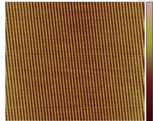

My research area is atom lithography. This technology’s description is as the following pictures.
Fig.1 Fig.2
Fig.1 describes the schematic overview of atom lithography. In a high vacuum(<1e-5 Pa) environment, the atom beam (Cr, 1650℃,925m/s) move to the substrate(Si,25℃) vertically. When the atom beam passes through the standing wave, the light field will change the atom trajectories to focus on the antinodes of the standing wave. Then the when the atoms arrive at the substrate, they have a density distribution, which forms uniform lines. The deposition process lasts about 1 hour. And the distance between the adjacent lines is 213 nm.
What I need to simulate is the process of surface growth of Cr on the Si substrate. And I want to get the visible process of the Cr deposition and the last picture of the deposition, just like the Fig.2.
