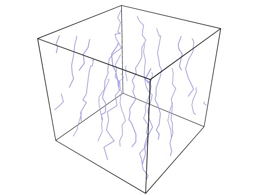

I am simulating an equilibrium system of high-density polymers. The simulation involves an initial relaxation in the NPT ensemble, followed by running it in the NVT ensemble. However, when I utilize the visualization software, I observe an unusual directional flow trend among the atoms. Could you please tell me how can I solve this problem or what might be causing the problem? Attached below is the code from my input file:

Could you post some snapshots of your system? It’s hard to know what’s going on from just the input script.
Sounds like the flying ice cube effect.

The trajectory line is shown in the figure, where periodic boundary conditions are used.
The question had never been thought of before. If so, how can I solve this problem? Really appreciate the help!
