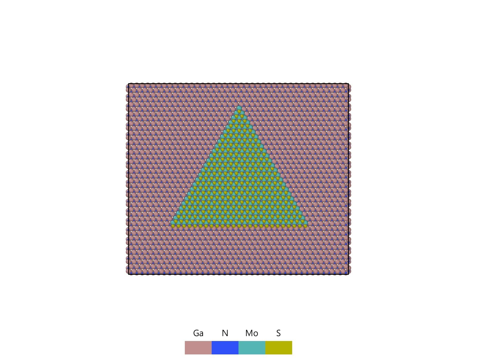

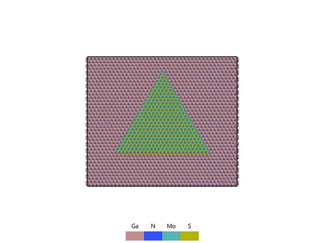

I am a beginner with LAMMPS and I would like to evaluate the strain in MoS₂ that is induced by lattice mismatch with a GaN substrate.
My LAMMPS version is 22 JUL 2025.
In my simulations I use a REBO potential for MoS₂, a Tersoff potential for GaN, and Lennard-Jones (LJ) cross-interaction terms parameterized from UFF for the MoS₂–GaN interface.
I place a monolayer MoS₂ triangular flake on three different GaN facets, (0001), (10-10), and (10-11), and run NVT simulations.
The simulations are performed first at 0.01 K, and then with a temperature ramp from 0.01 K to 300 K in NVT, in order to heat the system slowly and prevent MoS₂ from detaching from the GaN surface. From the dump files I post-process the trajectories to compute the Green–Lagrange strain tensor and compare the resulting strain in MoS₂ for each GaN facet.
Based on a simple lattice-mismatch analysis, I would expect MoS₂ on the (10-10) and (10-11) facets to experience stronger tensile strain than on (0001). However, in my simulations, the MoS₂ shows the largest tensile strain when it is placed on the GaN (0001) facet.

variable Qtemp equal  0.01  # K
variable tstep equal 0.0005
variable tdamp equal ${tstep}*100
variable relax_run equal 6000000
#----------initialize--------------------------------------
units	metal
atom_style	full
boundary	p p f
timestep ${tstep}
#--------read data-----------------------------------------
read_data 001.data
mass 1 69.723    # Ga
mass 2 14.0067   # N
mass 3 32.065  # S
mass 4 95.94  # Mo
group GaN type 1 2
group MoS2 type 3 4
#-------------FF-------------------------------------------
pair_style hybrid tersoff rebomos lj/cut 10.0
pair_coeff * * tersoff GaN.tersoff Ga N NULL NULL
pair_coeff * * rebomos MoS.REBO.set5b NULL NULL S M
# Cross pairs
pair_coeff 1 3 lj/cut 0.01462 3.750 10.0   # Ga-S
pair_coeff 1 4 lj/cut 0.00661 3.312 10.0   # Ga-Mo
pair_coeff 2 4 lj/cut 0.0026956 2.990 10.0   # N-Mo
pair_coeff 2 3 lj/cut 0.0059625 3.428 10.0   # N-S
# ---------- regions -------------------------------------
region bot block INF INF INF INF INF 4.509 units box
region top block INF INF INF INF 4.509 INF units box
#-----------group-----------------------------------------
group fbot region bot
group ftop region top
group GaN_fixed intersect GaN fbot
group GaN_mobile subtract GaN GaN_fixed
#-------------fix-----------------------------------------
fix f0 fbot setforce 0 0 0
#---------- neighbor settings ----------------------------
neighbor 2.0 bin
neigh_modify every 10 delay 0 check yes one 25000 page 250000
#----------minimize---------------------------------------
thermo_style custom step time temp pe etotal
thermo 1000
dump d0 all custom 1 before_minimize.dump id type x y z
run 0
undump d0
min_style       cg
minimize 1.0e-8 1.0e-8 500000 500000
compute mytemp ftop temp
dump d1 all custom 1 after_minimize.dump id type x y z
run 0
undump d1
dump d1 all custom 10000 traj.dump id type x y z
#--------------NVT ensemble_Temperature_Rampup------------------------------
fix f1 ftop nvt temp ${Qtemp} ${Qtemp} ${tdamp}
run ${relax_run}
write_dump all custom final.dump id type x y z
