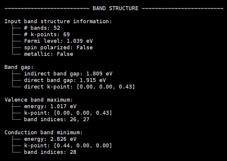

Dear @alex,
I noticed that the band properties and bandgaps output in the amset.log file are inconsistent with what I set in settings.yaml. Is this correct?
Looking forward to your reply!
Can you paste (not screenshot) the full log file?
Dear ALEX,
This is the output file I calculated, please help me check if there are any errors.

~~~~~~~~~~~~~~~~~~~~~~~~~~ BAND STRUCTURE ~~~~~~~~~~~~~~~~~~~~~~~~~
Input band structure information:
- # bands: 52
- # k-points: 69
- Fermi level: 1.039 eV
- spin polarized: False
- metallic: False
Band gap:
- indirect band gap: 1.809 eV
- direct band gap: 1.915 eV
- direct k-point: [0.00, 0.00, 0.43]
Valence band maximum:
- energy: 1.017 eV
- k-point: [0.00, 0.00, 0.43]
- band indices: 26, 27
Conduction band minimum:
- energy: 2.826 eV
- k-point: [0.44, 0.00, 0.00]
- band indices: 28

bandgap set to 2.830 eV, applying scissor of 1.034 eV

If you look further down in the log file you can see it applied a scissor operator to the band structure.
