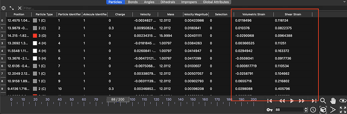

By default, OVITO outputs the Volumetric and the Shear strain as particle properties:

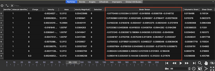

If you check the “Output strain tensors” option of the modifier you will get the full strain tensor for each particle as particle property as well:
These can be used for color coding, subsequent calculations, or exported directly.

The Strain Tensor is the atomic Green-Lagrangian strain tensor, while Volumetric and Shear Strain are the von Mises local shear invariant and the hydrostatic strain measure.
