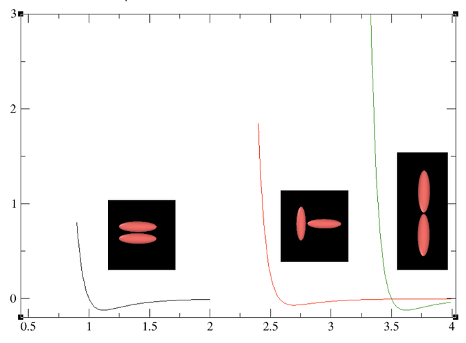

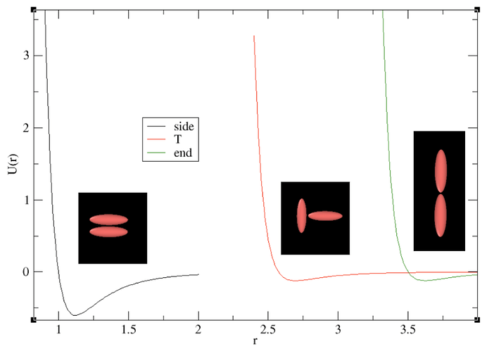

My first question is just about these because I don’t think I ever really got a good intuition about them. I know that they describe the face to face, side to side, and end to end interaction strengths but when I try to test the potential as a function of distance for different configurations I can’t really match these parameters to what I’d expect them to be based off the descriptions. I get good results with these parameters that match the typical gayberne behavior so I’m fine using them, but would like a more fundamental understanding of them. (Here is what I get using them for different configurations)

2 1 3.5 1 0.568477      0.0218931 0.822265 -0.0153452

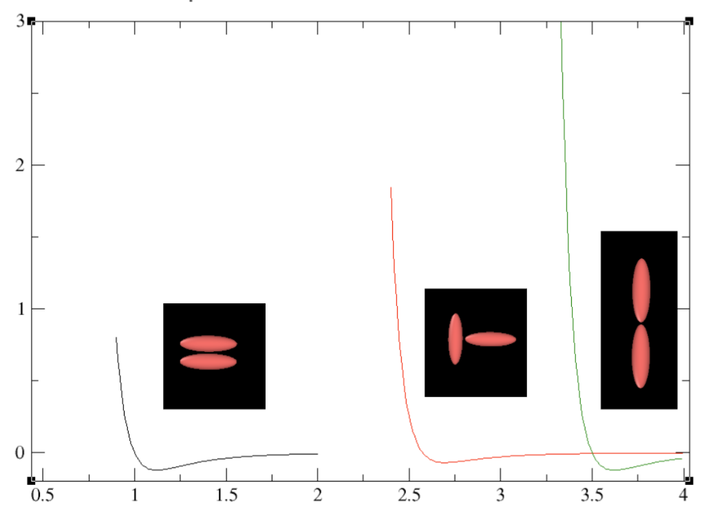

Then I get a different potential energy curve for the same systems (the side to side no longer has a stronger well depth, but the depth locations do not change)
However when I then switch the epsilon parameters to
pair_coeff      1 1 1 1 0.2 0.2 1.0 0.2 0.2 1.0
Then I get a match to the 2d case with zeroed middle quaternions for these 3 configurations. Even then it doesn’t match the 2d for more random configurations, but its at least more similar. This doesn’t make sense to me though because the only thing thats changed is the quaternions but not the actual angle defined by them (besides maybe up to some numerical noise that’s beyond 10^-5 in angles).
