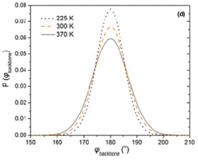

thanks, but i want the probability distribution and get a graph like the figure below.
for my case i have the angle and i wanna get f(angle).
that is a mere plotting / postprocessing issue. that graph is a histogram, only each column is divided by the sum of all column values.
