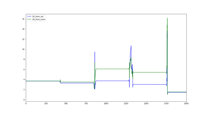

This wouldn’t be an issue, but then I found an energy/rotation inconsistency in the way principal axes seem to be defined. In other words, the angular momenta vs. angular velocities give me different rotational kinetic energies (as shown in the first plot). I take the system-fixed angular velocity, translate it into body-fixed and then calculate the energy based on the diagonalized inertia.This does not, however, agree with just taking the body-fixed angular momenta given by LAMMPS.

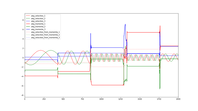

I believe this has got to do with some residue rotation, or I am not sure. If I take the angular velocity (in the system coordinates) and rotate it using the quaternion into the body axes I don’t get a ‘constant’ body-fixed angular velocity, but rather one component is fixed and the other two oscillate (that’s in the second plot - the dashed blue line is constant, but the red and green oscillate although I would expect them to be constant as there is no external torque).

I have managed to understand this issue properly and there is no error in the LAMMPS code - it was just my misunderstanding. Nevertheless, it would be useful to mention somewhere in the docs that both the angular velocity and momentum are given in system coordinates.
