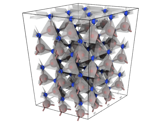

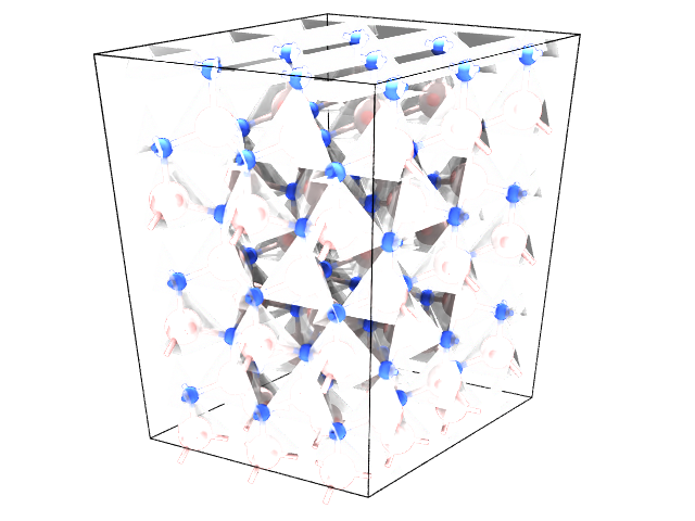

Interesting. These settings have a strong influence on the lighting, but none of them should completely prevent the rendering of surface meshes (coordination polyhedra). Here’s a comparison between the default AnariRenderer settings and yours for my test scene:
The coordination polyhedra appear overexposed with your settings, but they are still there.
