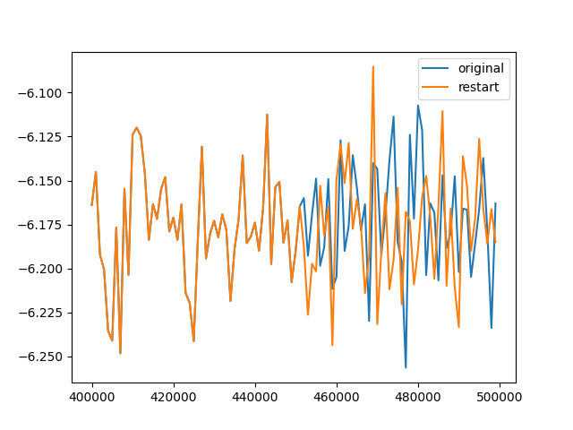

I am using LAMMPS version 22 Dec 2022 on a CentOS system to conduct a shear box deformation simulation. During the simulation, I used the write_restart command to output an atomic configuration at a specific moment as restart_shear.equil, and then continued the simulation for an additional 100,000 steps. Subsequently, I read the output restart_shear.equil from a different file and continued the simulation for another 100,000 steps.
I monitored the epair changes obtained using thermo_style for both 100,000-step simulations (the original one and the one reading the restart file). Initially, the two were almost identical, but after approximately 50,000 steps, differences began to emerge.
Is this a normal phenomenon due to finite computational precision, or have I made a mistake in my settings somewhere?
