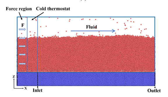

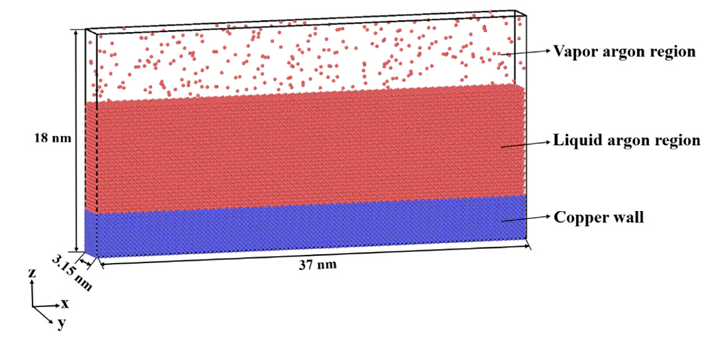

I’m trying to reproduce the results of the paper (I attatched) based on flow boiling characteristics. The paper studies boiling phenomenon in flowing argon. But after a short run, I see my argon temperature exceeds the heating base copper temperature (which I set 180K). The structure is okay. The parent paper uses LJ potential for Cu-Cu, so did I. The structure file is okay, as I’ve run it and checked.
Brief from the paper (names are given by me):
Fluid Domain (3 regions): Contains liquid and vapor argon undergoing flow (caused by ‘addforce’, the paper didn’t mention)
1st region: Name: force (10mm of 370mm along the length). I applied force here.
2nd region: Name: reset (10mm to 17mm). Fluid temperature is always kept 86k after passing this region to create constant temperature inlet in the next region. Langevin thermostat applied.
3rd region: Name: study (17mm to 370mm). Data is collected from this domain.
Copper Wall Domain(3 layers):
1st region: Name: fixed (bottom most layer, no heating, just supports the substrate)
2nd region: Name: ghost (middle layer, heating is here. Temp is raised to 180k of this region to study boiling)
3rd region: Name: real (no heating, just used for conduction. Transfer heat from ghost to liquid argon at its surface)
Reflective upper wall at z-axis where vapor tries to escape.
Initial Conditions: Inlet temperature set to 86 K.
Study region (17–370 Å): natural convective flow observed.
Simulation Parameters:
Time step = 2 fs. The paper says in brief:
  1. NVT run for 4 ns at 86 K for equilibration. System stabilized at 86 K.
  2. NVE run for 0.2 ns to heat Copper wall to target temperature (180k)
  3. Final NVE run for 4 ns for collecting data (my goal is temperature) to observe bubble nucleation and growth.
No mention of when to apply force. So I added it during equilibration.
My code involving main part of the procedure (My runs are much shorter, still temperature out of control):
