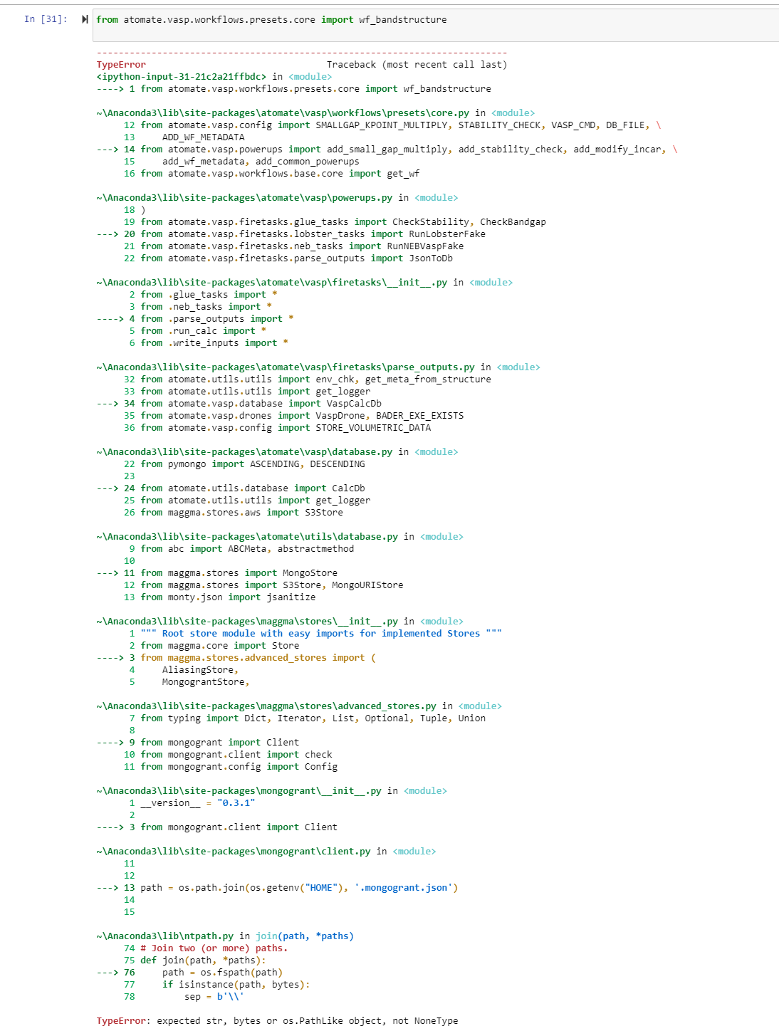

I am trying to run a workflow and keep getting this error. How do I fix this
Well, this is problematic. I’m assuming you’re working on windows, which is why the HOME variable would be None ?
Yes, I am working on my personal windows computer. How would I fix this problem?
The problem is in mongogrant which was not tested for windows use, but is included due to maggma being added as a dependency. We’ll try and release an update by EOD which should fix the problem.
Try upgrading mongogrant that should fix the issue.
It’s working. Thank you
