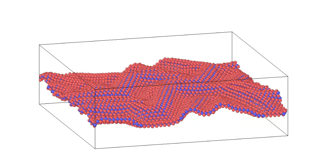

I am encountering a strange issue when running the same simulation for two systems of different sizes. As shown in the attached image, the monolayer starts bending significantly in the z-direction, forming large out-of-plane waves. The sheet should remain relatively flat in the xy plane, but instead it develops strong curvature and eventually collapses even before applying the deformation.
I am using exactly the same input script, potential, and simulation settings. When I run a 120 × 120 monolayer, the simulation runs without any file errors and the results look reasonable. However, when I run a 150 × 150 monolayer using the same setup, the atoms collapse after the two ensembles (see attached image).

It is hard to tell without seeing the input files, could you provide them? (potential files as well)
I’m suspecting that you use the same box sizes for both 120 x 120 system and 150 x 150 system, which could cause the ‘‘shrinkage’’.
It was just an assumption, it is clear for you but wasn’t that clear for us without your data files.
In your ‘‘Ti2N_main_data_file_120by120.lmp’’ data file atom 1 is N, atom 2 is Ti.
But in ‘‘Ti2N_main_data_file_150by150.lmp’’ data file atom 1 is Ti, atom 2 is N.
You should define the atom names in correct order when defining pair coeff
Hey Thank you so much for pointing this out. I honestly did not notice this small but critical detail before.
After checking the files more carefully, I found that this was indeed the root cause of the problem. The atom type ordering in the data files was inconsistent:
  • In Ti2N_main_data_file_120by120.lmp:
    atom type 1 = N, atom type 2 = Ti
  • In Ti2N_main_data_file_150by150.lmp:
    atom type 1 = Ti, atom type 2 = N
After correcting the atom types in the 150 × 150 system to match the ordering of the working 120 × 120 system, the collapse issue disappeared.
However, this raised another question that I do not fully understand.
Looking at the library.meam and TiN.meam files, it appears that Ti is listed first and N second. In my input script I also defined the pair coefficients in that order:
pair_coeff * * library.meam Ti N TiN.meam Ti N
Logically, this suggests that Ti should correspond to atom type 1 and N to atom type 2. That is exactly how the 150 × 150 system was originally defined, yet that configuration produced the unphysical collapse.
On the other hand, the configuration where N is type 1 and Ti is type 2 (which seems inconsistent with the order in the potential files) runs properly and produces reasonable results.
To confirm this, I also modified the 120 × 120 system to use the same atom type ordering as the original 150 × 150 system, and it produced the same instability.
So it seems clear that the atom type ordering is the root cause, but I do not fully understand why the seemingly “incorrect” ordering works while the logically consistent one does not.

The explanation of the ordering is given in the MEAM pair style documentation.
For the order after library.meam the ordering in the TiN.meam file matters, since in this file the atom types are referred to by numbers (1, 2, 3, etc) and you have to “extract” the parameters from the library.meam file in the same order or you will get incorrect results.
For the order after TiN.meam the order in the data file or however you create the atoms matters.
So you can have Ti N in one case and N Ti in the other.

There are two issues that I would like to point out:
  1. the free energy of a folded system is generally lower than for a flat system. As soon as you simulate the system with fix npt there is a chance it will bend or “crumple up” and there is no driver to keep it flat. this is not unlike a table cloth which requires to be pulled on the side to remain flat. … and a table cloth has the table as support, for which there is no equivalent in your setup.
  2. the larger your system gets, the easier it will become for the system to bend in z-direction. a) because less force is required and b) because larger systems allow for lower frequency motions. Keep in mind that you add kinetic energy to the system, so it will have motion.
You will have to study the simulation protocol(s) employed by similar studies to make certain that you are doing what is reasonable. Please always keep in mind that at the atomic scale you cannot easily apply and expect the same behavior as for macroscopic systems.
