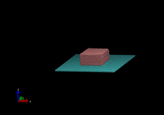

The attached is the picture of my initial geometry which is simple cube for the droplet and also the input script.
I used lj/cut force field with pair coeffs of 0.2398 for liquid-liquid and 0.1 for solid-liquid.

Dear Axel
Sorry for insufficient details.
​as i had suspected. you get out what you put in​. your choice of initial
geometry and your simulation protocol make it inevitable that atoms are
flying away.

the problem is your initial geometry and your simulation protocol.
you start with a "brick" of atoms. is this physically meaningful? no! is
this what a droplet looks like? no!!
especially the atoms at the corners and edges have very li​ttle that holds
them back. ever heard of surface tension? ever though about what the reason
for that is?
so a more realistic starting geometry would be a whole or a section of a
sphere.
but it doesn't stop here. you are placing atoms, assign a (randomized)
temperature and start your simulation right away. is this likely to be a
realistic starting point? no!
so you have lots of atoms with high potential energy or potential energy
that isn't consistent with the kinetic energy and so on. you need to get
rid of some of these inconsistencies. i.e. you have to relax and
equilibrate your system. and have to do it carefully.
finally, if you are simulating a droplet with a soft interaction (as
opposed to, say, a water droplet, which has strong water-water forces
between them), you have to expect a high fugacity, i.e. atoms may easily
leave the droplet, since it doesn't require much kinetic overcome the
surface tension (there is rather little of it). so you have to start your
simulation *very* soft and carefully, e.g. equilibrate it at a much lower
temperature and very carefully heat it up. then put a reflecting wall
around your system to contain any atoms leaving the droplet and building
suitable liquid/vapor coexistence conditions.
i strongly suggest, you discuss the "design" of your simulation with your
adviser, since it looks a lot, like you haven't fully thought through what
you are trying to do and your problems are not problems of missing LAMMPS
experience or incorrect usage of LAMMPS commands, but rather bad choices
for how to set up and run your system. you'd have the same problems with
any MD code, if you'd use the same starting geometry and simulation
settings.
