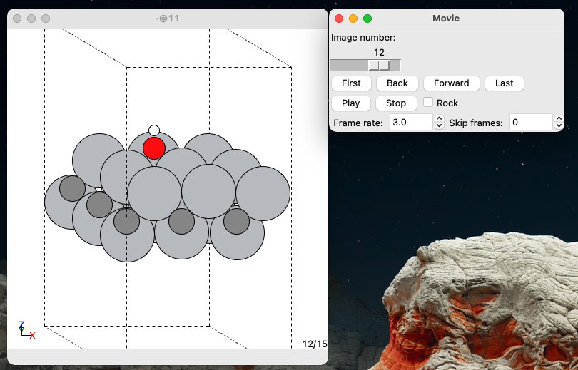

And generates a movie containing the structures for all the adsorbed species
