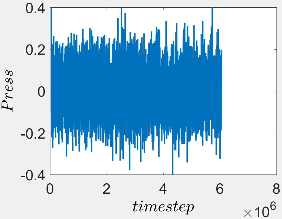

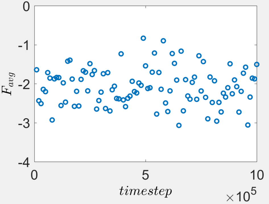

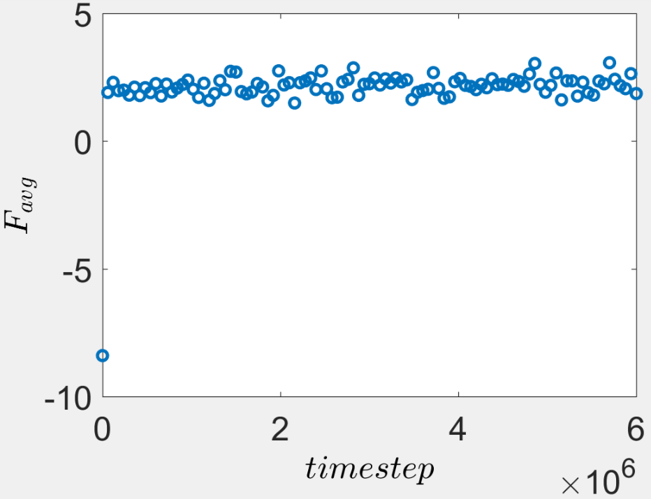

The system pressure fluctuates about zero as shown in the figure below. Therefore, the system is relaxed thereby the fixed volume under NVE ensemble is the equilibrated volume. Nevertheless, the average FENE bonds in the polymer chains (measured every 60000 timesteps) are slightly compressed as seen in the second figure. Furthermore, the average bonds were also slightly smaller than the pairwise equilibrium bond distance. (The force in each FENE bond was outputted by compute b2 all bond/local force.)

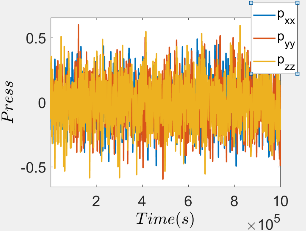

I was trying both harmonic and FENE. Even when the system pressure (in the x, y and z) is zero where all the bonds in my polymer chains (subject to NPT ensemble) are harmonic, I still see small compression. I averaged all the harmonic bond force in the polymer chains at designated timesteps (as shown below) and every averaged bond falls below zero (for symmetric harmonic potential)
A tiny force implies that the system itself is not fully relaxed (pre-compressed). However, the second plot shows that the system is fully relaxed and the average pressure is zero with small numerical roundoff negligible compared to the offset I am seeing in the average bond force.
Also, for the case with asymmetric FENE bonds, even if the bond force is tiny, then I should see a small non-zero system pressure when I average. However, the average system pressure turns out to be very close to zero negligible compared to the compressed offset I am seeing with the bond force.
