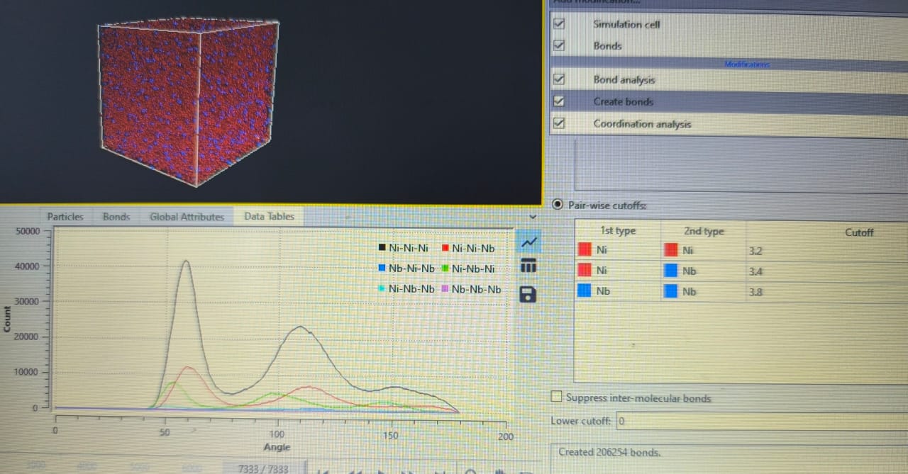

I am a doctoral student using OVITO to analyze molecular dynamics simulation data of a Ni-Nb.
To characterize the local atomic structure, I need to calculate the Bond Angle Distribution (BAD) and the Bond Length Distribution (BLD). I am looking for a way to do this programmatically using a Python script modifier, as I need to process a large number of simulation files.
Could you please guide me to any example scripts or relevant functions in the OVITO Python API that can be used for these calculations? Any assistance or examples you could provide would be greatly appreciated.
Thank you for your time and for developing such a powerful tool.
As you correctly identified, you can use the Coordination Analysis modifier to obtain the particle-particle distance distribution.
If your system already contains chemical bonds, or if you can infer reliable bonds with the Create Bonds modifier, you can use the Bond Analysis modifier to obtain both bond-angle and bond-length distributions simultaneously.
I’ve linked the Python documentation for these modifiers.
