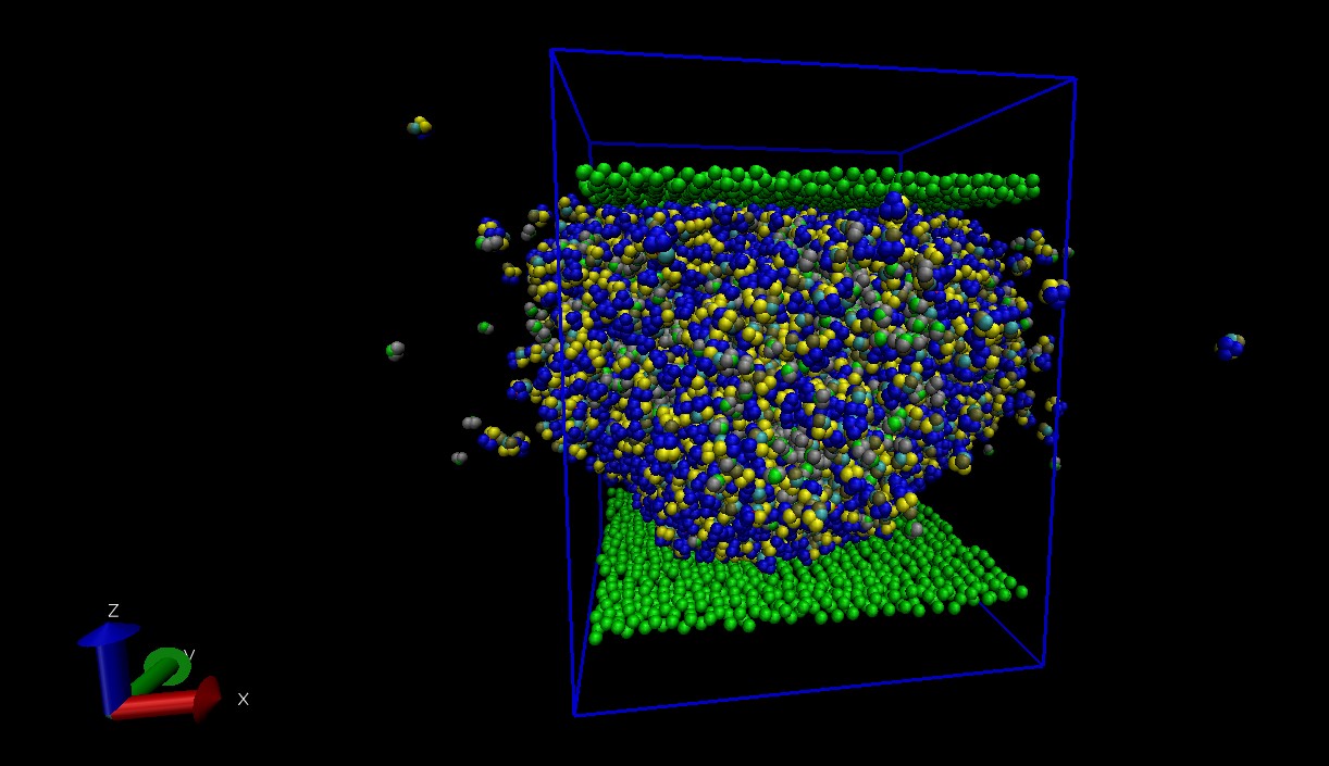

I have a simulation of water + alcohol in a channel which is non-periodic in z. I have attached a VMD image of the system just before the crash. When I try to use a higher timestep of 0.5 fs, I get “Bond atoms missing error”. I don’t get this at lower timesteps. The system properties also seem stable to me (I have attached a snippet of the log file).

You seem to have a water molecule slip past the wall at the top left of your screenshot. If the molecule has really gone past the wall (and it’s not just an illusion of perspective) that will definitely crash your simulation.
Yes, you are right. It’s an ethanol molecule. It’s not an illusion, its position is actually beyond the wall. Is this because of how the “kspace_modify slab 3.0” is being implemented? I tried to hold the walls in place by fix spring/self to prevent leakage from the wall, and is there a way to do this more properly? Thanks.
Well it seems that the ethanol molecule was able to slip in between your wall particles and thus out past the wall. The problem is more basic than a kspace issue, which is that since LAMMPS expects the z-axis to be non-periodic you cannot have any particle go past your stated z-axis limits.
Since you know the physics you are trying to simulate, you will have to decide how to make the wall properly impermeable – whether through adding more layers, spacing the wall particles closer together, having a tighter spring/self spring constant, or adding a wall/reflect that doesn’t affect dynamics outside the wall and only starts reflecting particles that are starting to enter the wall.

The main cause of the crash was the molecule going beyond the wall as srtee pointed out. I found that the wall did not completely span the box in the x and y periodic dimension. I fixed this, used a smaller lattice spacing, and increased the force constant slightly to still be consistent with what I want to do. Everything is okay now and I can run at 1 fs for however long I need. Thank you all.
