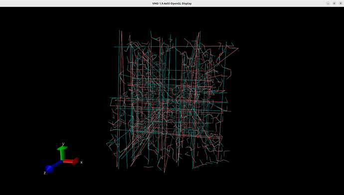

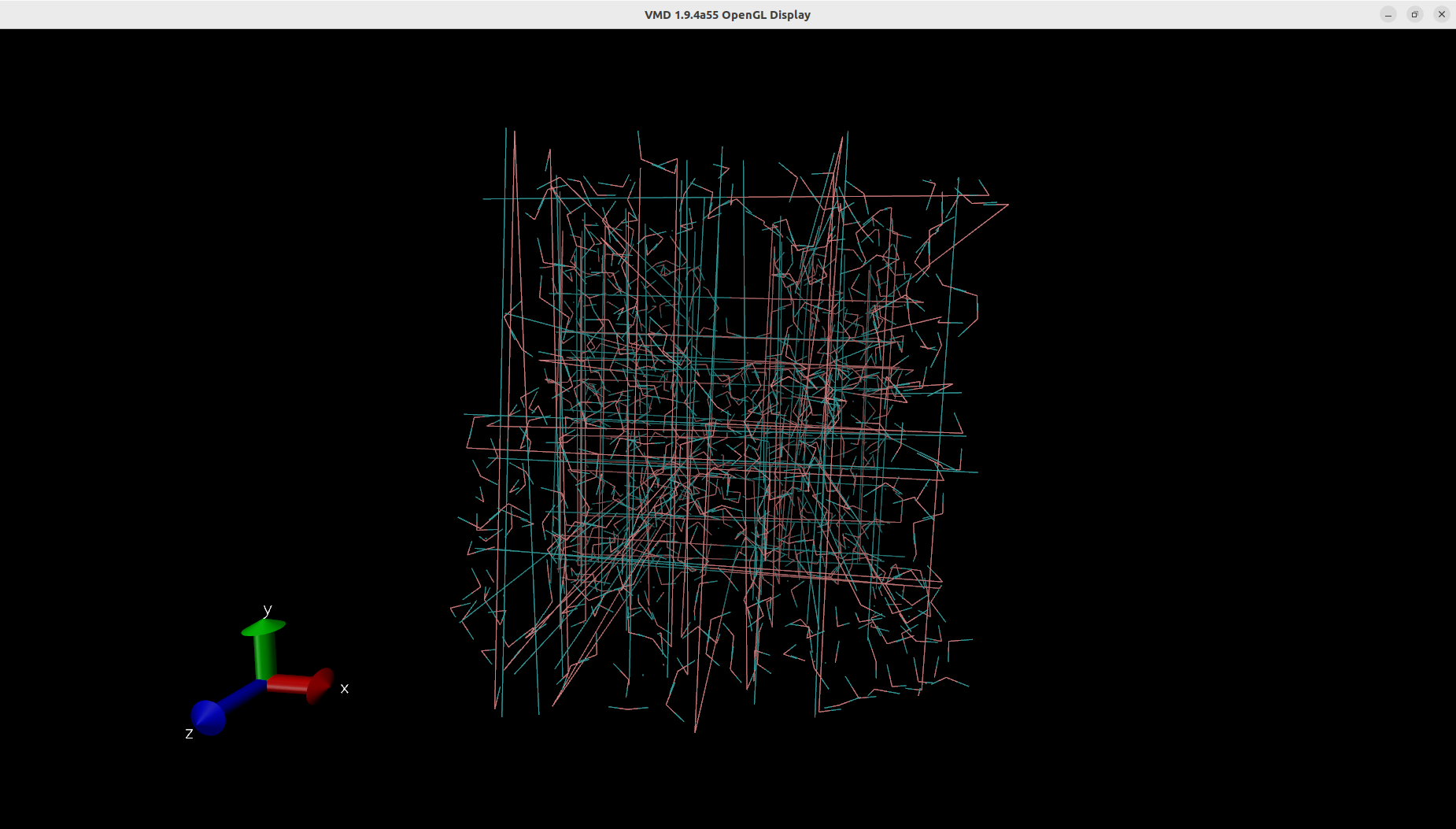

While simulating water using the spce water model the bonds are getting too much strected on the boundary. What can be the possible error
This looks like a visualization artifact resulting from visualizing a trajectory of wrapped coordinates from a system with periodic boundaries.
Try saving unwrapped coordinates.
