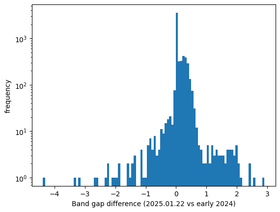

Meanwhile, I made a quick analysis of my query cache from early 2024 vs the results of same query as of today with mp-api==0.45.1, and I see a lot of differences.

Here is a histogram of band gap change between the two versions for the common IDs:
Let me know if you’d like me to share my cache from early 2024.
Hope this info helps the investigations.
Hey @SiLiKhon thanks for your patience. The way we parse band gaps changed slightly Nov, 2024 to improve reliability. The bandgaps of some materials will also changed then to use the r2SCAN bandgap, which tends to be larger than the PBE gap. Other differences are accounted for by the change in NSCF task types.
Longer explanation:
In Nov of 2024, we modified the schema for how we store information about VASP calculations as tasks. As part of that, a field called eigenvalue_band_properties was removed from the calculations field
Now, there are many ways to estimate the band gap from either an approximate dispersion relationship/band structure or the DOS. Estimating the gap automatically can fail because of how the CBM, VBM, and Fermi level are determined
The advantages to the current approach over using eigenvalue_band_properties are summarized in this pymatgen issue. The newer scheme is not as sensitive to Fermi surface broadening techniques. If you’re not familiar with this, it’s basically an approximation we use to treat the partial occupancy of the Fermi level in metals and ensure computational stability.
In the material you found mp-1211100, the eigenvalue_band_properties field gave a very large band gap of 6.139 eV despite the fact this older method also found the CBM to be just below the Fermi level.
That doesn’t make physical sense, and it’s likely that the bandgap is actually 0 eV, consistent with the current bandgap shown there. Indeed, there was also a recalculation of that material that found a 0 eV bandgap
There are <1,000 materials which used this less reliable bandgap estimation method (thanks to @tsmathis for finding that!) in the pre-Nov 2024 version of MP
