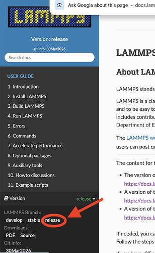

I think I know what’s happening here.
I went to the documentation link with the latest stable release:
In the search area labelled “search docs” I typed in “Kokkos optional”, I click on the link for Kokkos and I am stealthily taken to docs for version 30Mar2026. However, if I follow the links within the stable release web page and not use any links returned by the search bar, I get the correct version of the web pages that don’t have any mention to the Kokkos precision CMake option.

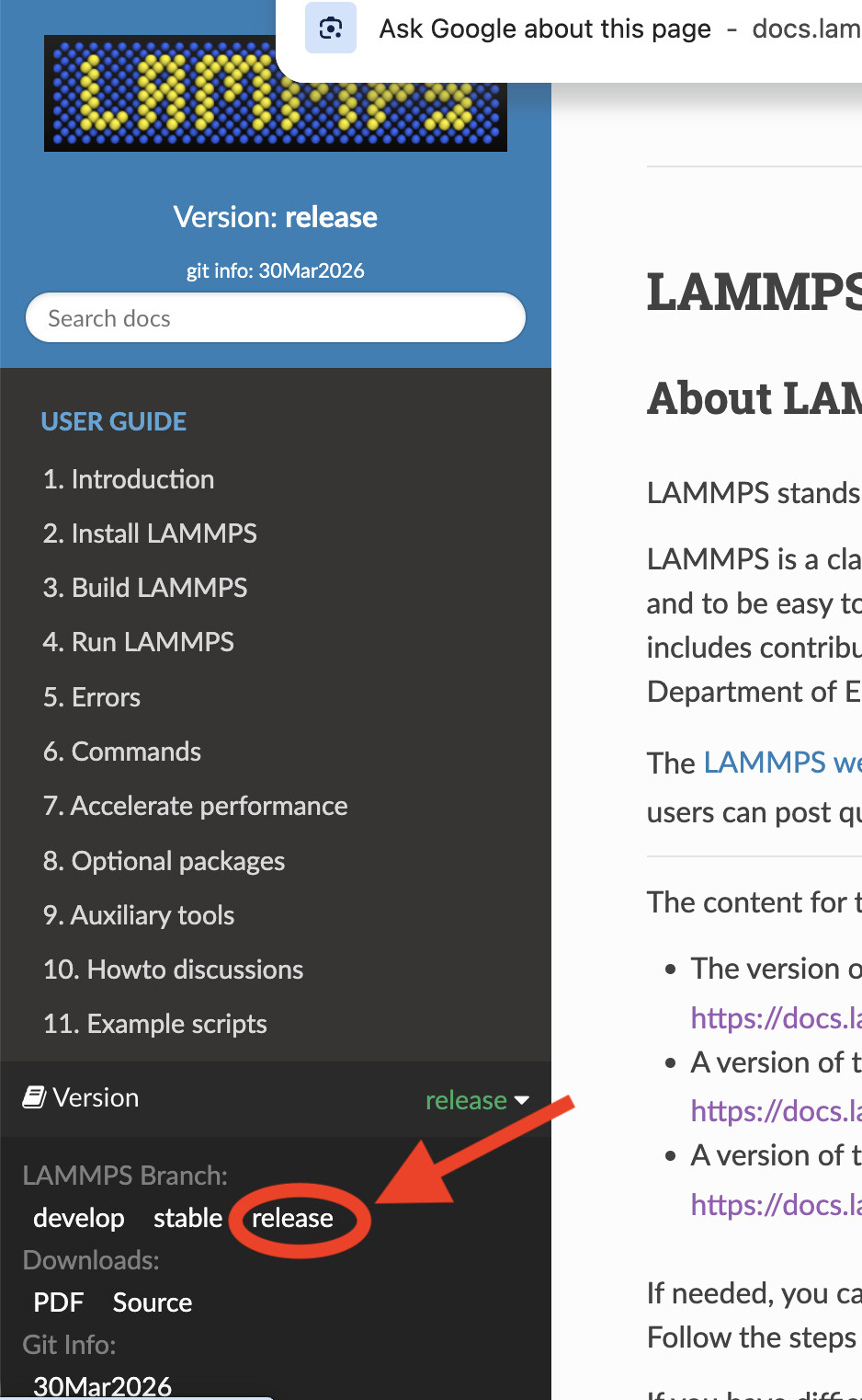

You need to click here:
