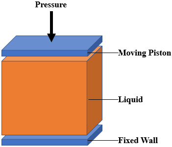

In my simulation I apply pressure on a liquid as you can see in the picture below. The liquid is placed between two plates. One of them is fixed and another one applies pressure.

I decided to calculate pressure and temperature by a dump file outputs. I saved x y z vx vy vz fx fy fz. in the dump file.
I calculate temperature by KE = 3/2 N.K_B.T and the result was the thing was expected. For pressure I used P= N.K_B.T/V + 1/3V sum(r_i . f_i) and I set V = the volume of the region, T = the temperature calculated in previous section and for r_i and f_i I used the data saved in the dump file. But when I do this calculation I give wrong answer. My pressure must be 100atm but I see 168 atm. Is it possible for someone to help me?
I run my code parallel, real units is used and the boundaries are periodic in both x and y.
Also you can see the python code I use to calculate pressure.

because of the details of my simulation box, I don’t think that’s possible.
after reaching equilibrium in my system, I remove the moving piston and the wall below it. therefore some liquid will evaporate and I have both vapor and liquid in my system. I want to calculate the pressure of both states and the thing is that my liquid is moving in the box, so it’s not possible to define a fixed region and then calculate their pressure.
