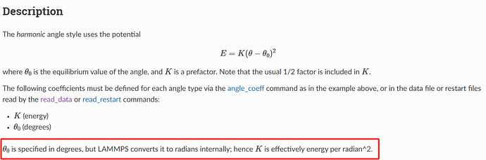

Dear Akohlmey,
I think I know where the problem is.
Hanqi
