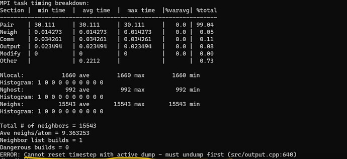

It was beacuse of udump command that I used. I do not know why my lammps version (15 Jun 2023) considers lack of undump command in my input file as an error.
Therefore, I have to inactivate reset timestep so that it does not need to add udump command and finally the dump file became longer including all 1(ns) diffusion.
