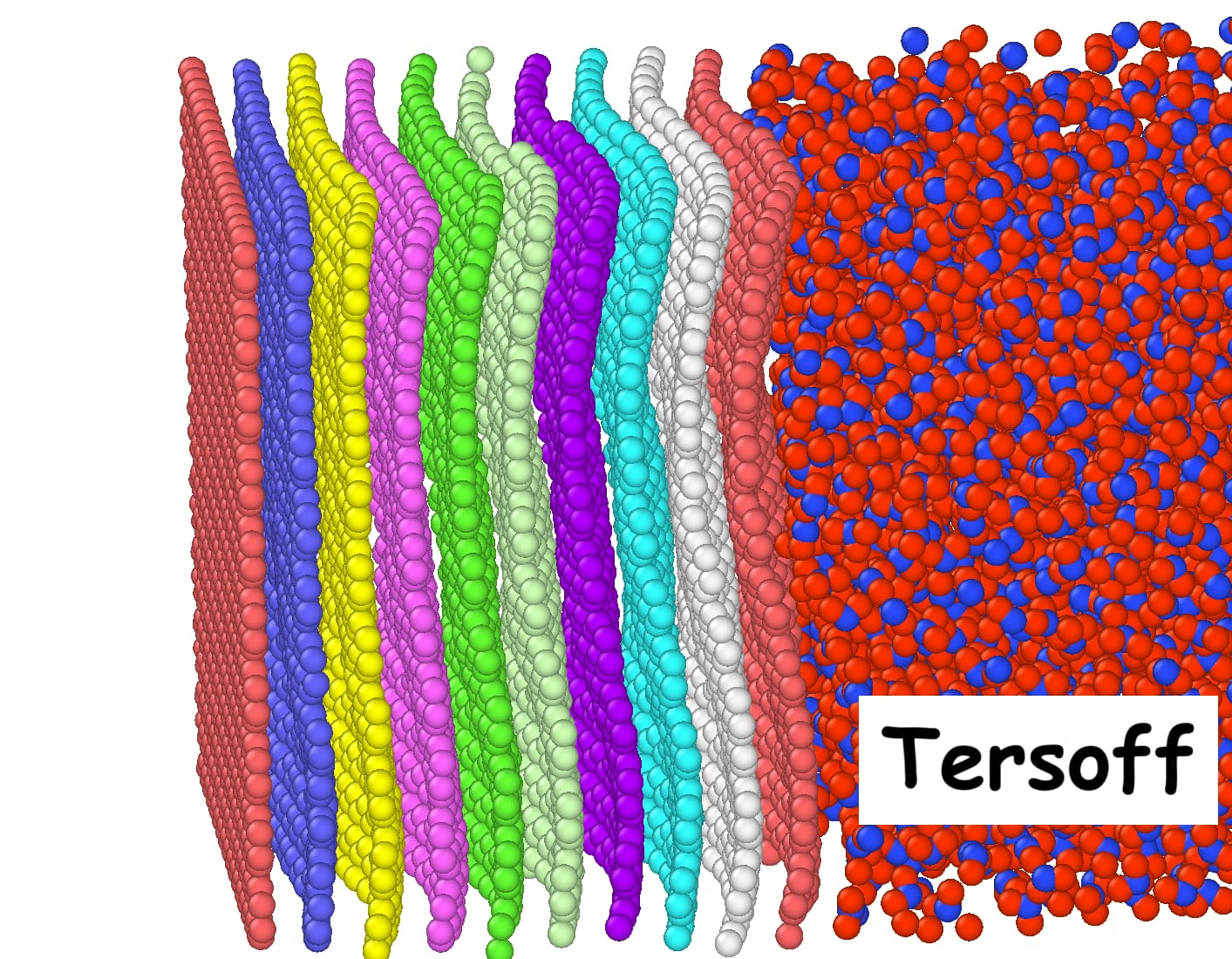

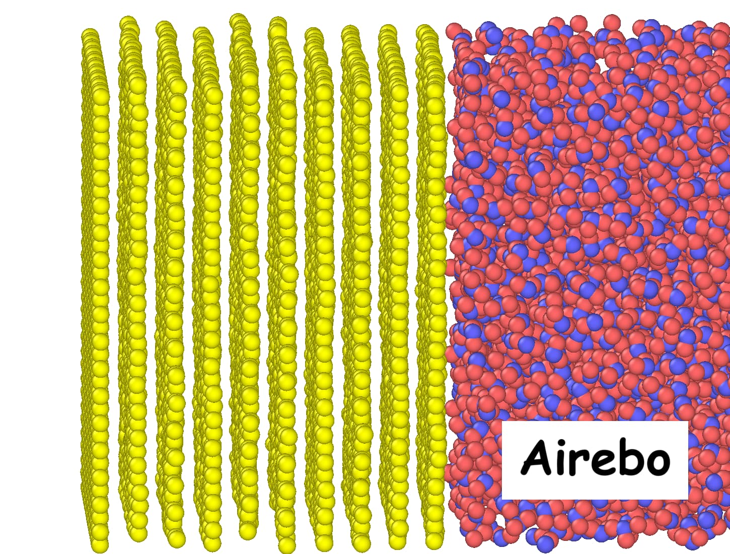

I have implemented the AIREBO potential in my simulations and obtained good agreement with a reference paper regarding Kapitza resistance and heat flux. However, **I’m facing issues when switching to the Tersoff potential: graphene layers deform significantly (bend or warp) during the simulation.Snapshots taken toward the end of both the AIREBO and Tersoff simulations are attached for visual comparison.

To prevent deformation of the graphene sheets, I have separately tested both fix spring and fix spring/self. The reference paper suggests fixing the center of mass (COM) of each graphene layer, so I used fix spring for this purpose. However, it didn’t prevent warping.
Alternatively, I tried fix spring/self, which ties each atom to its initial position. This reduced deformation and matched AIREBO’s behavior more closely. But since this approach constrains individual atoms rather than the COM, it seems unphysical and also alters the heat flux depending on the spring constant.

I cannot answer this in general and with great confidence, since there is simply too little tangible information in your post, but I can speculate: have you considered that AIREBO and your Tersoff parameterization may have a different equilibrium C-C distance? Your snapshot image looks like the the sheets are buckling because they cannot relax the way they “want” and “be straight” due to too small box lengths in the periodic dimensions.
