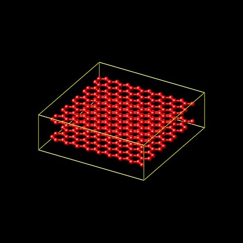

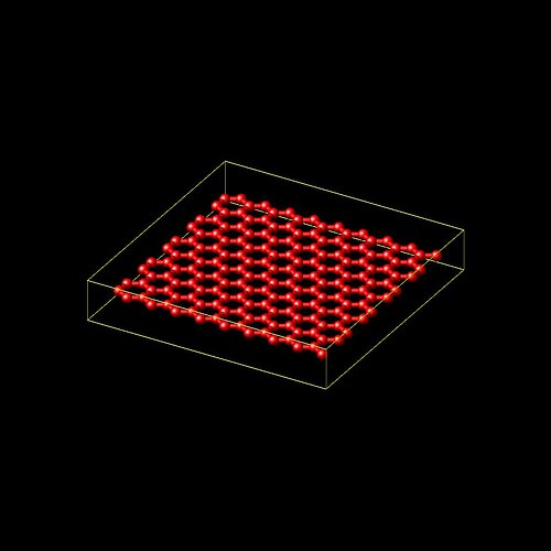

please point me to the exact text in the manual. I have been using the replicate command regularly and it never did create bonds between the old coordinates and the new and it should not. i am attaching an example input deck demonstrating my case. this is using a graphene sheet created by VMD, then assigns force field parameters (taken from the CHARMM force field for a Phenyl ring carbon) and then creates a second sheet on top of it using replicate. I am also attaching images created with the write_dump image command.
you can see from the log file that after reading the data file, the system has:
180 atoms
251 bonds
466 angles
871 dihedrals
and when writing out after replication it has:
360 atoms
502 bonds
932 angles
1742 dihedrals
so exactly double and nothing more. the images confirm this.
please keep in mind, that these images show the “real” bonds as defined by the force field and in the topology.
if you read coordinates into a visualization program, it may try to guess bonds from distances and then show you bogus bonds that do not exist.
Axel.
