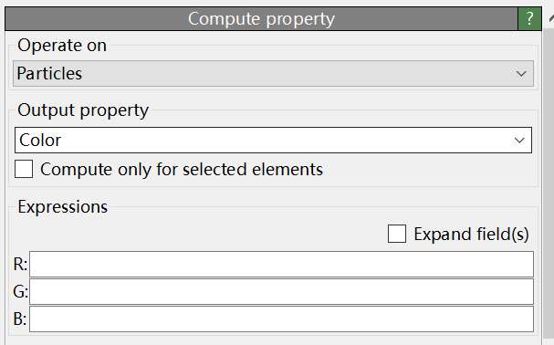

I found the Compute property can compute the color of every atom, including RGB. Can I color atoms by the output, , and how?
thanks in advance

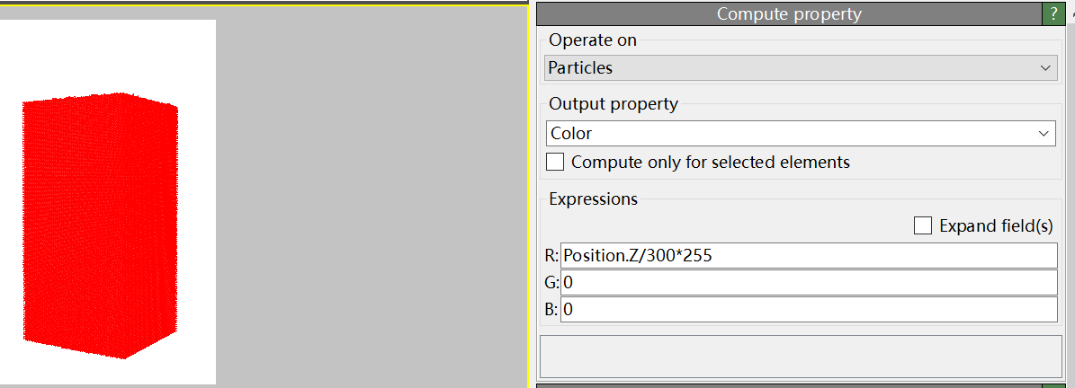

I tried to input calculation parameters, but the particle color was not the function of Position.Z
Hi @mmt_jiang,
The color tuple is coded between 0 and 1.
So if your box origin is at Z=10, you would use a formula like
(Position.Z-10)/CellSize.Z to color your particle in red using a linear scale from 0 to 1 depending on their height.
