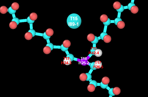

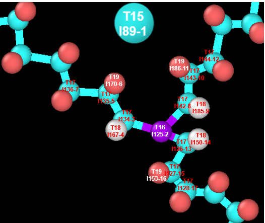

I don’t quite understand what bond connectivity refers to here. As shown below, I want the atom T15 I89-1 and atom T16 I125-2 to be bonded. To achieve this, I included as many atoms as possible in the pre-reaction template (17 atoms, including three bonds around atom T16 I125-2). However, the reaction is not triggered.

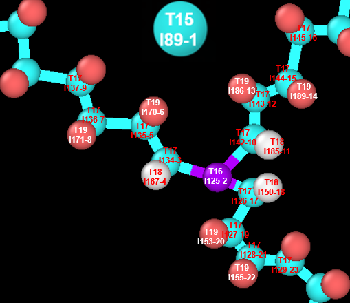

Next, I tried including different numbers of atoms in the pre-reaction template, as shown below,
When the pre-reaction template contains 11 atoms and 23 atoms, as shown above, the reaction will not be triggered.

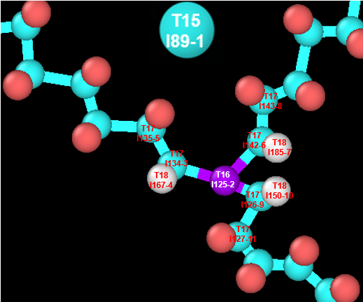

Finally, the reaction was triggered correctly when there were only 5 atoms. I am now confused as to how many atoms need to be included in the pre-react template.
